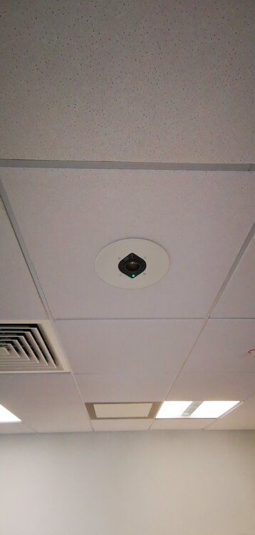

We use Wolfvision Eye-14's. Come with a ceiling tile adapter so it can be flush mounted in the ceiling.
One big advantage these have is a laser dot which shows the center of the image. It's pulsed at a rate that's out of sync with the cameras frame rate so it doesn't show on the image.
Yes they're expensive, but I've never had to replace one yet and have never had any complaints from the users (mostly medical professionals in dissection settings).

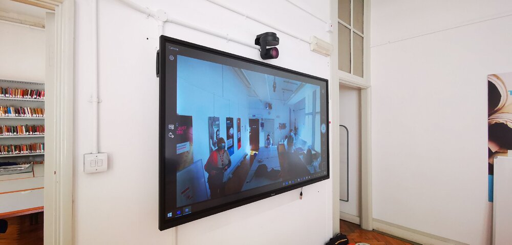

We've got a Logitech PTZ Pro with motorised pan / tilt and zoom, all operable from a simple remote control. Plugs in to a PC / Chromebook as a standard USB camera, no extra drivers needed. I know it's being used at another school, ceiling mounted, to film science practical lessons - you can pre-set fixed x,y,zoom positions for it to point at (the teacher's desk, the science fume cupboard, etc) and have them as shortcuts on the remote. They were about £750 on Amazon a little while ago - that's cheaper than the one mentioned above (£5,400!), but still quite pricy.

One thing with PTZ cameras, check they can point directly down (when ceiling mounted!). Just installed a Logitech Rally cam to do a dual role function (ceiling visualiser and normal PTZ work) and we've had to mount the camera at an angle so we can get a straight down shot. Makes the install look a bit messy but it works.
If you want pictures of the Eye-14 in-situ I can post some tomorrow.
Pics would be nice if it's no problem. I've just noticed the rallys have a ceiling mount kit
I'm going in to sign off an install we've just had done with Rallys and an Eye-14, so will post them up when I can. Not in a medical setting for once so I can share the pics!

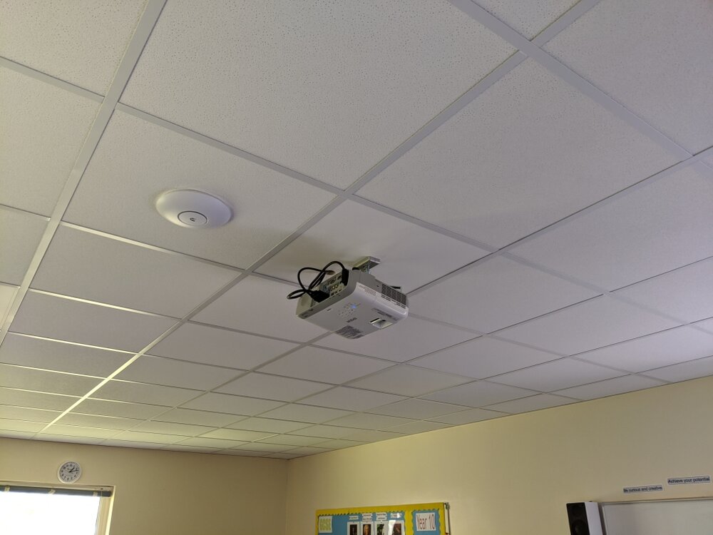

Proper ceiling visualisers have a load rated, primary suspension method (bracket) and secondary suspension method (safety wire) that must be installed correctly. I'm from a theatre background where we fly stuff over peoples heads all the time so a little more paranoid about this stuff than most.

Here's one of my projector installs, offcut of 25mm ply (from home) cut (at home) painted (at home) Don't know why I do it tbh.
If I jerry rig, I jerry rig properly :)
[ATTACH=CONFIG]60988[/ATTACH]
You can tell that's a good job, because I was like huh why would you paint wood if it's above the ceiling tile, before realising there was no tile!
