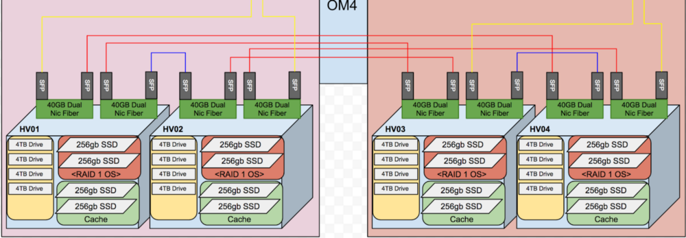

Each node has 4 10gb nics and I have each node connected to each other using 3 of the 4 nics with the 4th being the connection to my main network.

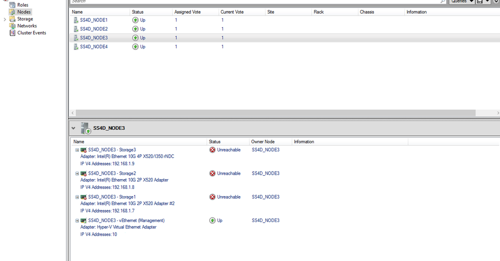

I am trying to connect each node as a direct connection with no switch, I have given them separate IP addressing to my main network but they show as no connection with each other on those connections, I am missing something here anyone able to point me in the right direction.
This is what it shows in FCM:
This is how I have connected the cables:
Firstly I assume you realise that’s not a supporter config? Only 2 node switchless is
But in terms of actually getting it to work I think you have to use separate subnets on each connection, they shouldn’t clash in terms of routing where currently they are with you using similar ips etc
Might be worth a try on one
