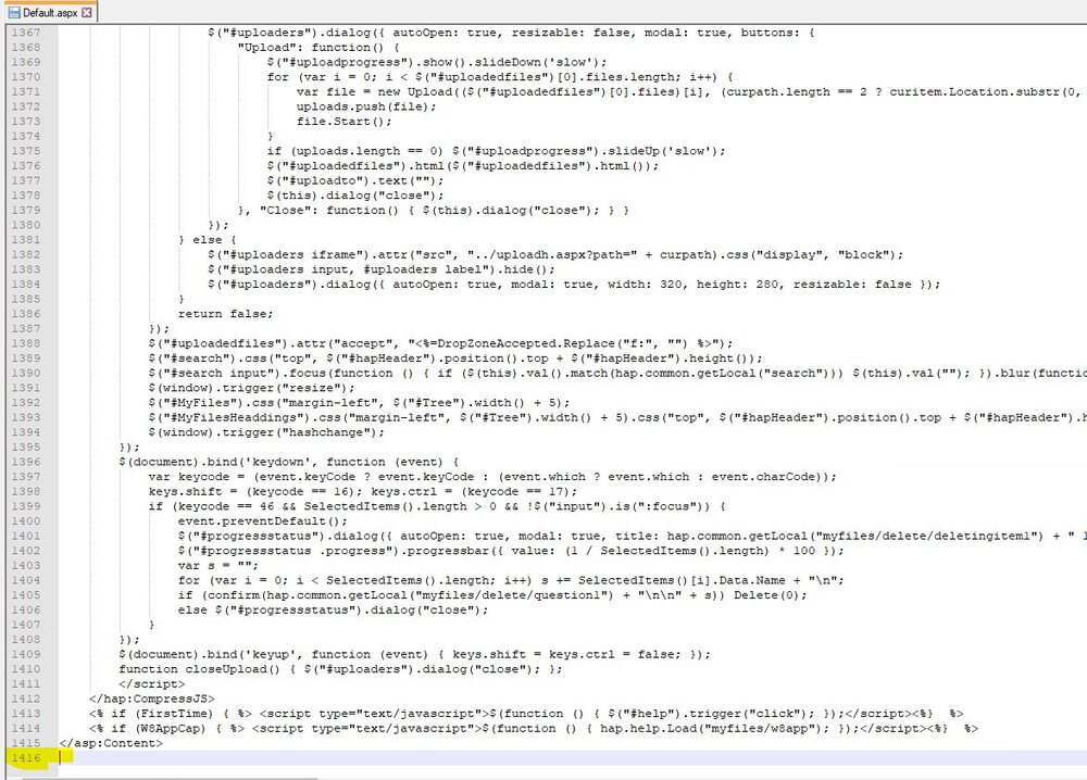

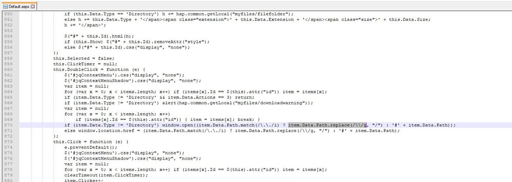

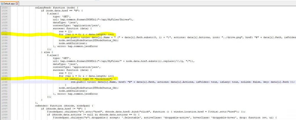

@nickbro Before editing i wanted to check with you that the line numbers married up - I don't have a line 1432.
Please check the images to see if they are correct

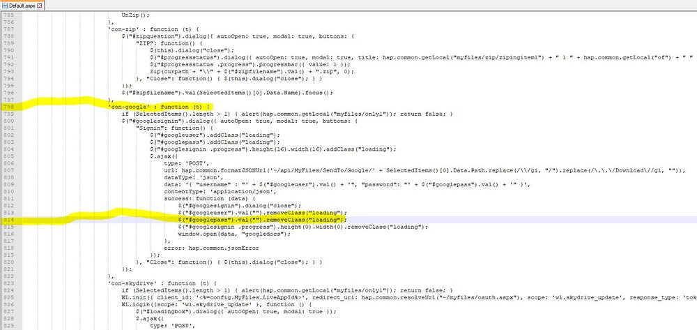

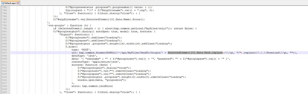

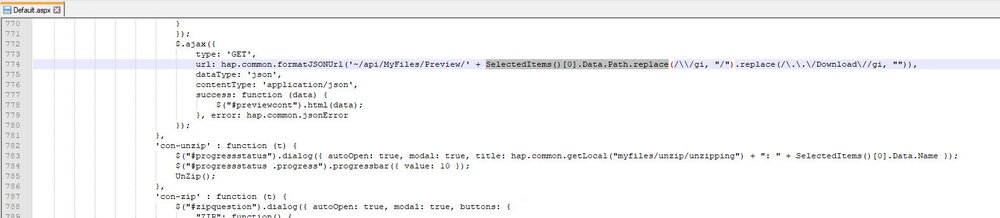

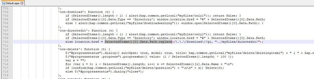

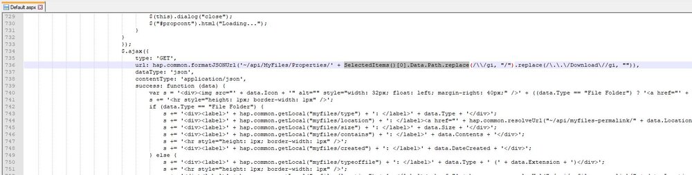

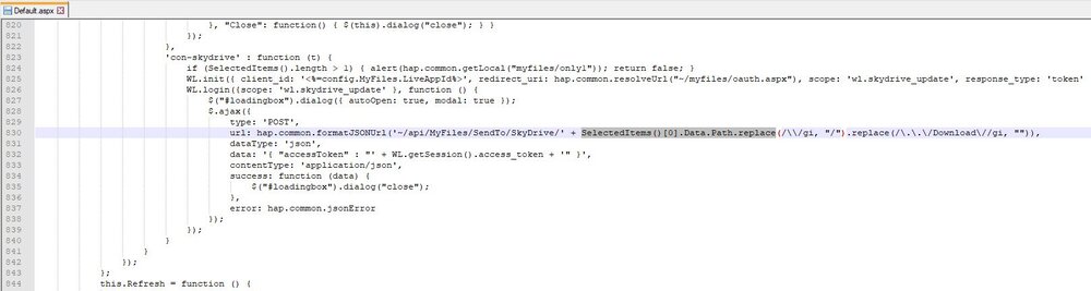

Ok, i've done a search and found the following - a few more than just on 3 lines.
SelectedItems()[0].Data.Path.replace:
Line 170
Line 710
Line 736
Line 774
Line 807
Line 830

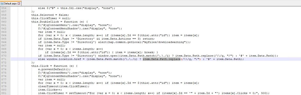

item.Data.Path.replace
Line 870
Line 871
870 should be it
Thanks, so
OLD:
if (item.Data.Type != 'Directory') window.open((item.Data.Path.match(/\.\./i) ? item.Data.Path.replace(/\\/g, "/") : '#' + item.Data.Path));
NEW:
if (item.Data.Type != 'Directory') window.open((item.Data.Path.match(/\.\./i) ? [b](item.Data.Path.replace(/\\/g, "/") + '?' + Math.Random())[/b] : '#' + item.Data.Path));
What about the other one i need to change?
Thanks, so
OLD:
NEW:

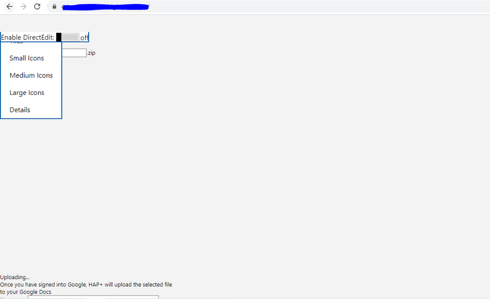

@nickbro editing only line 870 didn't work - in fact it made the site not render correctly.
