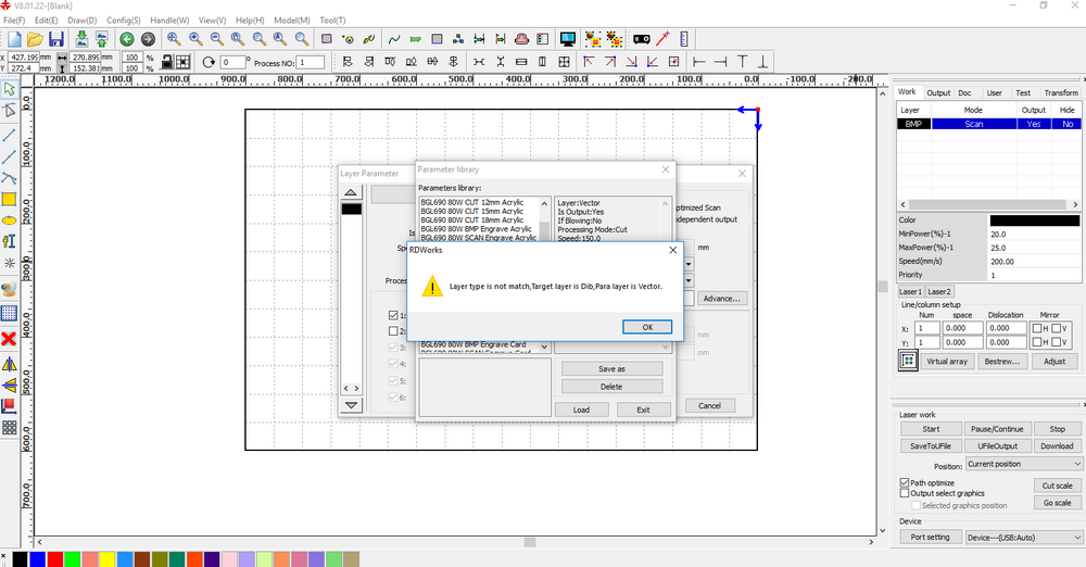

I'm hoping some amung you may have some laser cutter knowledge and might be able to help me out. The attached image is take from RD Works as you will see. We don't know what the relevance of the error message is, however when we send the file to the cutter it does to what we want it to do...? This seems to happen on a few images both PNG and Jpeg. It doesn't happen on every Parameter setting though.
Any light shed or thoughts welcomed.

I don't use RD Works, but a dib is a raster graphic type, and it's expecting a vector graphic type. it's the way the image data is stored, vector graphics are scalable without loss of fidelity, and more suited to cutting/engraving. Try using an SVG image, I imagine it won't give you that error then.
