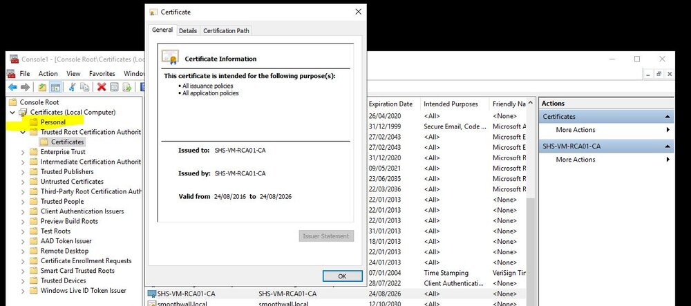

I think the following is the Root CA certificate that has the long validity on it which is located in the Domain Trusted Root Certification Authority > Certificates.

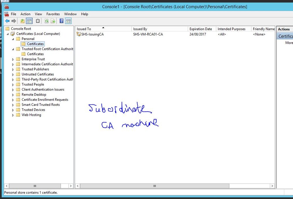

The Subordinate CA has a certificate from the Root CA in the Personal > Certificates store but this has expired by 2.5 years:
