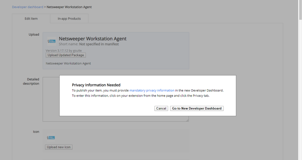

I'm helping a primary school who have just bought some chromebooks, I've got an extension from Schools Broadband which I want to force install on all of them, but I'm stuck.
I've uploaded the extension and set it to private, but it's currently in draft - I'm assuming I need to publish this however when I try to publish it it tells me to go to the new Google Developer Dashboard and accept the privacy policy. When I follow that link to the new dashboard, I then get an access denied message saying that I need to get an administrator to grant me permission to it. When I look at the apps/services available in GSuite I can't see an obvious developer dashboard that I need to enable/add/allow to let me access it.

All I get when I try to publish is the attached which then says I don't have access.
The instructions I got from Schools Broadband said to make it a private app, anyway I've tried making it unlisted and still have the same problem.

For anyone else who ends up struggling with this - it's covered under "Access to additional services without individual control"
