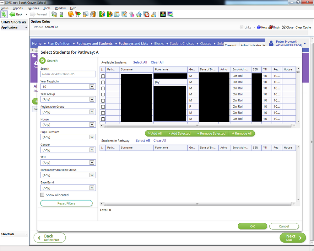

My colleagues are setting up plans for 2020/21 but the students are still showing in last-years year group (ie a current year 11 student is showing in year 10 on Options).
How/where does Options Online data come from?
On a (probably related note) the SIMS Service Manager is showing attached. I've installed patch 25266 (Sims online Services Schema) and restarted the service but no change.

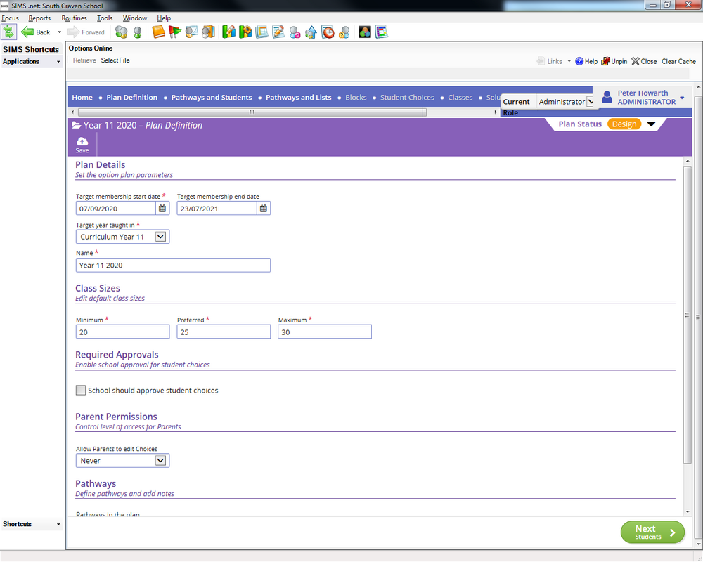

I've just logged in and looked; she swears blind that she had setup academic promotion but there's none there. (She's setup new academic year ok).
I've put in rules for 10>11, but it still showing wrong in Online.

I just created a year 8 into 9 plan to test this for you and it's working fine - we've not done anything outside the options-online interface. no promotions for the next year set up yet either.
The common issue is not realising that you need to set the target membership date to sometime in the next academic year then pick the year group they'll be in at that point in time.
when you go to the select students page it'll show you the year they are in CURRENTLY - so i picked 3/9/2020 and a target group of year 9 - then on the next page it showed me the current year 8s.

Date is 07/09/2020, Year is 11, student picker is showing year 10's who would be in year 11 next year - as you describe.
But, the year 10's it is showing are last years year 10's, currently in year 11, who will be in year 12 next year.
I know the student called Jay on the screenshot and i've double triple checked he's currently in year 11.
