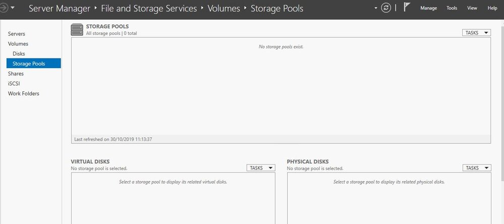

Mini emergency; When doing an in-place update to server 2019 from 2012R2 my Virtual Host PC has lost its VM storage (D: drive)
I can login to the RAID manager (megaRAID Storage Manager) but cannot see the disk in disk management or storage.
My other VM machine that is configured identically (still on 2012R2) suggests no issues, but I'm reluctant to use powershell as I know the data is there, I just need to mount the drive -
Can anyone help? I've never seen this before, but assume it's because windows doesn't like drives more than several TB's (?)
Screenshots attached

Sooo, apparantly they say it's because this was a locked drive (?) something to do with tier storage to prevent data theft?
TBh this is getting odd so I may now just restore the VHD's from backup - It's been one of those days!
So Thursday Update;
Seems rebuilding the server was the only option, which is odd as all my other servers (10+) updated perfectly fine (Except SIMS, I'm not stupid enough to update that)
As it turns out I was able to restore the VHD's directly from Windows Server Backup after a full rebuild, so it was a good test of our emergency response systems.
