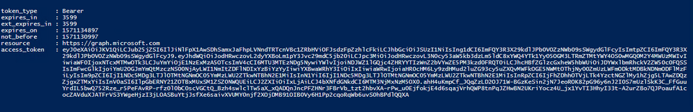

So the idea is that you can run the above function in PowerShell:-
Get-AZGraphToken -ClientId be68bfbd-4012-b52c-b56b-d1e421c0bc62 -ClientSecret oM3LA449hap78CK?A_dpU[m@7nb-AXDH4 -TenantDomain 'plumtreeservices.onmicrosoft.com'
You should get what is shown in the attached screen grab.
