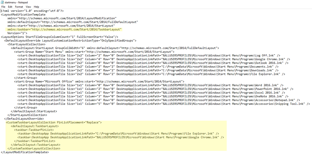

thimon Posted August 19, 2019 Posted August 19, 2019 Hi @Cazale. We've got both File Explorer and Google Chrome pinned to the taskbar within the custom start menu xml, please see below photos for the xml file and the end result (ignore all the other pinned taskbar icons after Google Chrome as I've pinned those). The text highlighted in yellow is what sets the custom taskbar layout. 1
Cazale Posted August 19, 2019 Author Posted August 19, 2019 Looking at that, it looks like I didn't put in the XMLS:taskbar at the top. I'll have another play. Thanks for your replies.
Cazale Posted August 20, 2019 Author Posted August 20, 2019 Yep, it was the xmlns:taskbar="http://schemas.microsoft.com/Start/2014/TaskbarLayout" missing from the header that was causing it to fail. Thanks guys. 1
