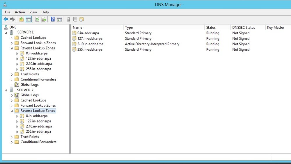

What do you have set up as your reverse lookup zone(s)?
Not quite sure I follow...
Hopefully a picture is worth a thousand words!
So, in the 2.10.in-arpa one, is the address you are trying to reverse DNS listed?
If I go into one of my reverse lookup zones, there are IP addresses listed, with the data showing the hostname. These get populated by the DHCP server IIRC, as the 2 are integrated.

Yeah, if there's no PTR in the reverse lookup zone, you won't get a valid response doing a reverse lookup.
Yeah, that seems like your issue - if you're not using the MS DHCP server, then no dynamically assigned machines will get reverse zone records added.
So, you're seeing what you should then.
Your reverse lookup zone ought to be a /24 not a /16. This will not be helping and might even be causing the problem.
i.e if your network is 10.2.0.0/23 then you should have two reverse lookup zones:
0.2.10.in-addr.arpa
1.2.10.in-addr.arpa
Also ensure the DHCP server is setting the DNS suffix value correctly as otherwise it will not work correctly. You could also try experimenting with "Computer Configuration\Administrative Template\Network\DNS Client\Register PTR Records" GPO settings and similiar.
