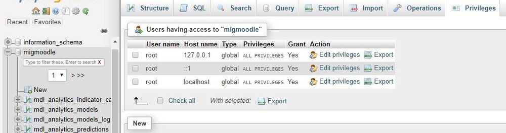

Yes, I had set the permissions correctly i.e, a root user with all privileges without password, same you can able to see in the topic section.
FYI - Check image,
Please check and suggest if I miss anything.

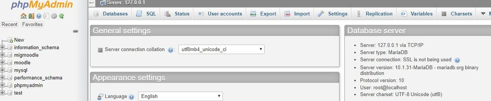

Yes it is correct! phpmyadmin is supports dytype mariabd also. Even it worked when installing fresh moodle.
FYI - phpMyAdmin is a web-based tool that allows webmasters and students manage MySQL or MariaDB databases.
FYI - I had installed Moodle on local and the version is 3.6.3. And I am trying to migrate the moodle on local itself as a practice and to know the correct process for future references.
Yes, when installing V3.6.3 I got barracuda error and I had updated the required data in my.ini
Please check below screenshot;
