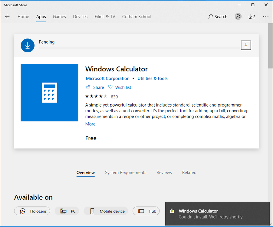

I've changed that setting and now have the following message coming up, any suggestions would be appreciated.
Cheers, eddyc
I think you have to all a domain unauthenticated and no SSL interception. I can't seem to find it. If you use fiddler and/or smssnif you should be able to find it.
