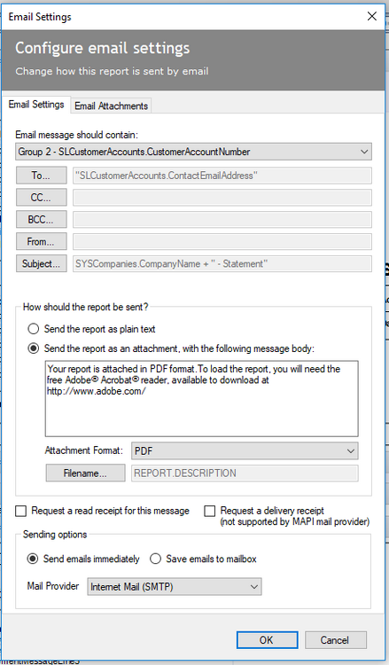

Okay, I was ill on Friday so didn't get chance to see finance and sort out their Statement emailing. I've been over this afternoon and finally got it to work after a couple of hours.
First thing is to open the template/report in the designer. At the top select: Report > Email Settings. You should see this:
Make sure at the bottom you have selected "Send email immediately" and change the Mail Provider to "Internet Mail (SMTP).
Click OK to save these settings.
