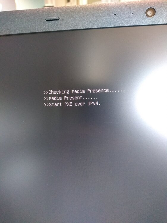

What am I doing wrong.
I can’t get UEFI laptops to PXE boot. There are legacy setting in the BIOS.
Other devices with legacy PXE all working as they should, I can images them from SCCM.
I have IP helper address set pointing to my SCCM server.
I have set the DHCP options 60, 66, 67 as shown.
If I boot a UEFI laptop it gets to the screen ‘checking media’, ‘media present’ and then stops.
Is there someting else i need to change in SCCM
Cheers

I have removed all the DHCP options still get this, but did see PXE-E16 error flash up

Update,
I put this new UEFI only laptop on the same VLAN as the SCCM server, it booted, TS loaded and run, laptop now sitting happily with win 10 on it.
This VLAN does have an IP helper address on it pointing to the SCCM server.
So far so good.
Teacher VLAN has IP helper address on pointing to the SCCM server, no extra DHCP settings.
If I now put the laptop on this VLAN, it doesn’t work, I’m back to the image I posted before (above).
If I now add in DHCP scope option 60,66 & 67. It now seems to work.
I’ve compared the switch config and there is no difference between the way the two VLANs are setup
Anyhow things seem to be working now, so thanks for the help

Check BIOS booting on the teacher VLAN now. You may have broken it specifying options needed for UEFI booting. The way around this is to use Policies in the DHCP configuration. The client identifies which mode it's booting in when it sends its request and the DHCP server can then hand out the appropriate options.
