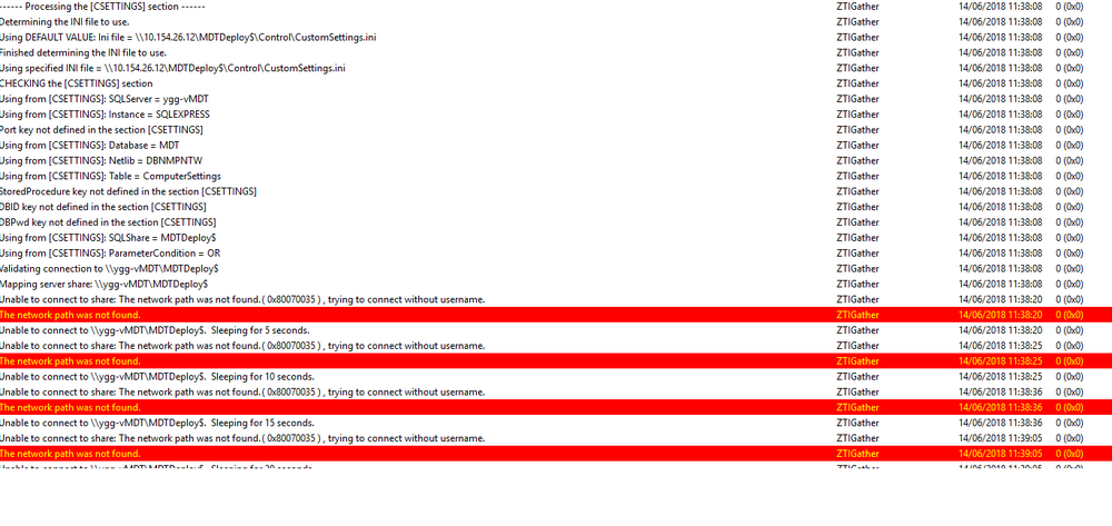

Could someone take a look at this ztigather log and help me?
I'm building machines fine - so the server is working. But when it gets to the database section of it all it seems to loose connection and cannot find the share.
Can anyone help? Or tell me why?
Thanks
Gareth

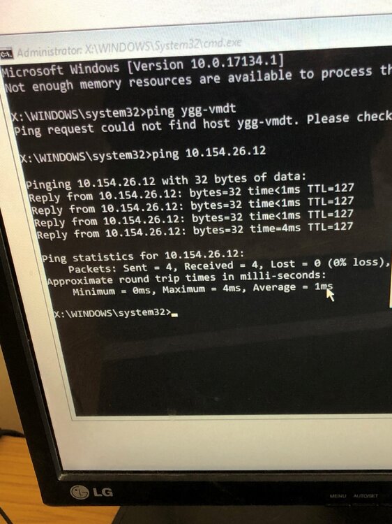

I'm wondering why my machine, when deploying cannot resolve ygg-vmdt
Going to try with IP addresses.
Suggests to me a DNS issue - but what would I ask the LEA - as they hold our dns servers.

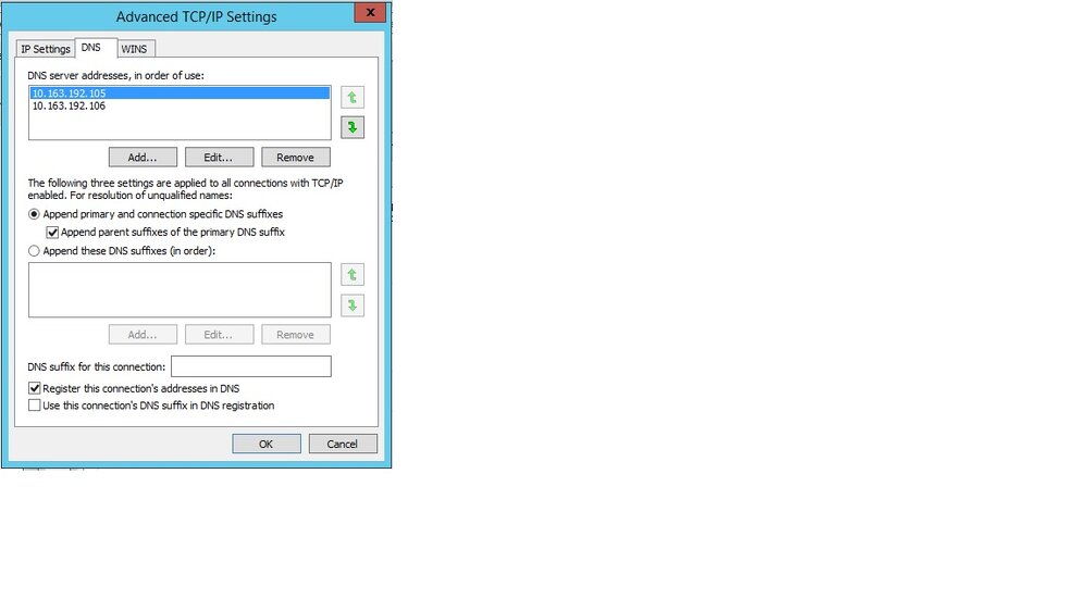

I've asked the question, but I'm not sure how to do the last bit: "check on your nic settings is it set to update dns etc"
Every day is a school day.
Gareth
If you go to the nic in control panel, and access it's properties, ipv4, advanced etc etc you'll find the DNS tab
Right near the bottom should be an option to register this connections addresses in DNS which should make it re-register in the zone if it drops it's settings, but if you're using static etc it might not be on
Steve
Steve
Cheers Steve - alas it seems we have it set.

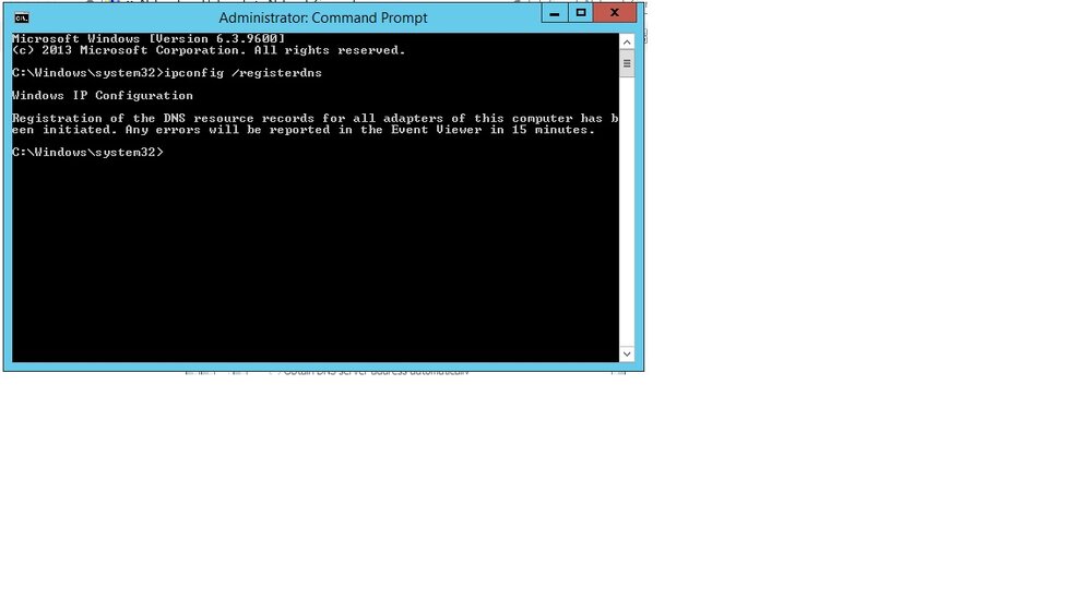

Look in event viewer under system and you should have a dns client event with "proper" details if it failed :p
Steve
I have a feeling this explains it:
Normally if that's erroring you're either missing a reverse lookup zone, or the dc isn't accepting non-secure/dynamic updates for that range.
Not much you could do with either if it's on their end though, probably best to wait for them to add a static in for now
