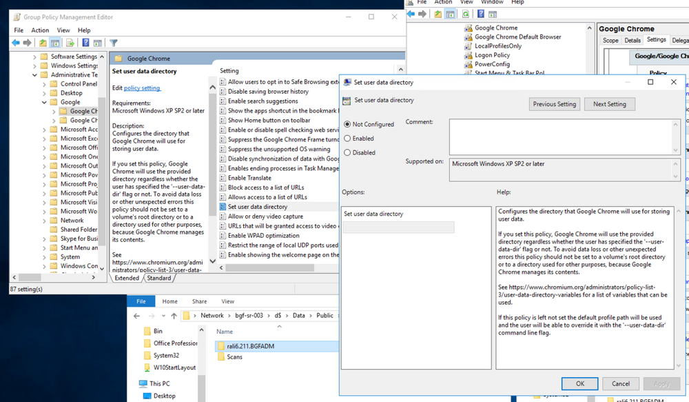

I have found the following setting within Group Policy, not sure if this might help me:
I have looked the setting up in more detail https://www.chromium.org/administrators/policy-list-3/user-data-directory-variables and it seems you could put in ${documents} as a variable which would point it to the Documents folder for the current user. This might work, though may look a little untidy to have user data in their My Docs.
[ATTACH=CONFIG]49175[/ATTACH]

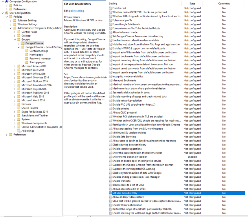

I only seem to have Set user data directory on mine? (as below)
@talksr that sounds like you need to update your Chrome policy definitions - get them from here https://enterprise.google.com/chrome/chrome-browser/

I am getting a couple of Google Folders in the policy now which is odd. Not looked for the profile path setting yet.
Hi all, me again.
Still having trouble finding the part of Chrome Group Policy that allows me to set the profile location?
Does anyone know where it is? I have updated the definitions for Chrome as mine seemed outdated, but I am still struggling to find the part that allows me to change the profile location.
