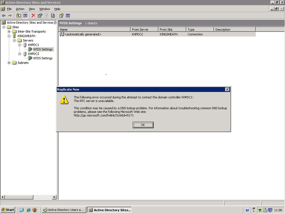

bmdixon Posted April 15, 2008 Report Posted April 15, 2008 Over Easter we set up a whole new network. We've been getting an error when testing replication between domain controllers. Replicating on KHPDC2 works fine but when on KHPDC1 this error occurs... I have no idea what is causing this?! Any help would be very gratefully received!
adamf Posted April 15, 2008 Report Posted April 15, 2008 Can you resolve the names of the servers from each other using nslookup? Any errors in event logs? DNS errors would be a good place to start.
Geoff Posted April 15, 2008 Report Posted April 15, 2008 Presumably you've checked your DNS is sane and working?
bmdixon Posted April 15, 2008 Author Report Posted April 15, 2008 (edited) It seems to be working now.... i did a ipconfig /flushdns and then ipconfig /registerdns and a couple of minutes later it works.... DNS is/was working fine, i could ping the server(s), no problem. Thanks for your advice EDIT: Spoke too soon. It's back, but seems to be coming and going....! In the eventviewer when i run ipconfig /registerdns i get the following error: The system failed to register pointer (PTR) resource records (RRs) for network adapter with settings: Adapter Name : {3EB3183C-947A-46D4-86AE-0A9C9AFAF00F} Host Name : khpdc1 Adapter-specific Domain Suffix : KINGSHEATH.local DNS server list : 10.125.16.55, 10.120.224.105 Sent update to server : 10.120.224.107 IP Address : 10.125.16.56 The reason that the system could not register these RRs was because of a security related problem. The cause of this could be (a) your computer does not have permissions to register and update the specific DNS domain name set for this adapter, or (b) there might have been a problem negotiating valid credentials with the DNS server during the processing of the update request. You can manually retry DNS registration of the network adapter and its settings by typing "ipconfig /registerdns" at the command prompt. If problems still persist, contact your DNS server or network systems administrator. Edited April 15, 2008 by bmdixon
bmdixon Posted April 15, 2008 Author Report Posted April 15, 2008 10.125.16.55 is our internal DNS (and also our secondry Domain Controller)

SYNACK Posted April 15, 2008 Report Posted April 15, 2008 Weird it seems to be trying to update your records on 10.120.224.107, is this one of your servers also. It might be helpful to post up an "ipconfig /all" so that we can see whats going on with your net cards configurations. Random thought, do you have more than one network card in the system as this could be causing it some confusion. I would try adding the record manually in the DNS server snapin on your DNS server. This can sometimes get through weird security issues that occur as the record then exists and it is only an update.

ezzauk Posted April 18, 2008 Report Posted April 18, 2008 Hi ya do you have 2 nic's pluged in on the server in Q?, as if there both on the same ip range this will cause problems. The best option if you want the two nics working on the same ip range is to trunk them on the server and switch.
