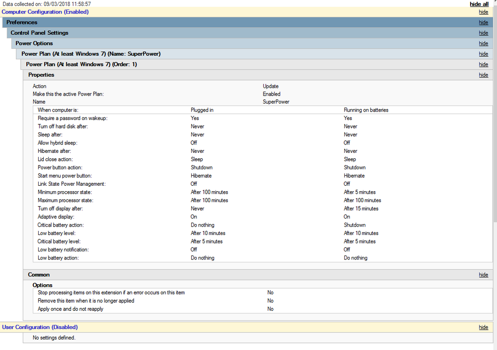

I found the high power one did it, but if you create a custom one and put it all to highest it doesn't. (Something silly to do with the default ones take Win10 settings over them, but putting a forced one overrides it)
Pretty sure that was the only change I did overall, will run an rsop on one of them in a min but might want to just try it like this (as a demo and can change anything after):
