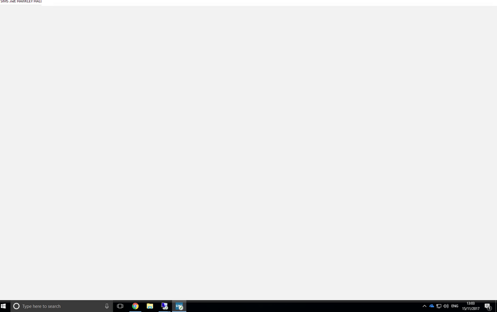

We don't use SSO so perhaps that could be it. We get the dialog box to login and then the splash screen OK. It's just the SIMS home / dashboard that doesn't seem to work it goes all white. We aren't using any DPI in Windows, and are running Windows 10 1703. Currently testing on a physical machine that we are intending to use remote app with. Just using the onboard graphics on the host. Have tried it on VMWare hypervisor previously and had the same issues
[ATTACH=CONFIG]46231[/ATTACH]

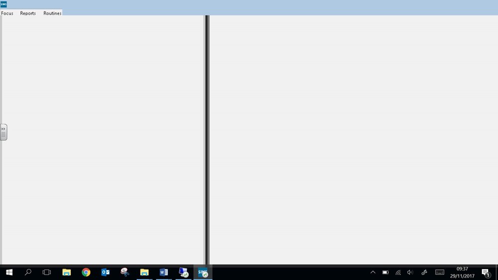

This is what happens with us - on loading up after entering your user/pass SIMS will flash on the screen correct - full screen but then disappear minimised, opening it back up from the taskbar will show you this. Which is similar to your issue. We have to click top left for it to become available.

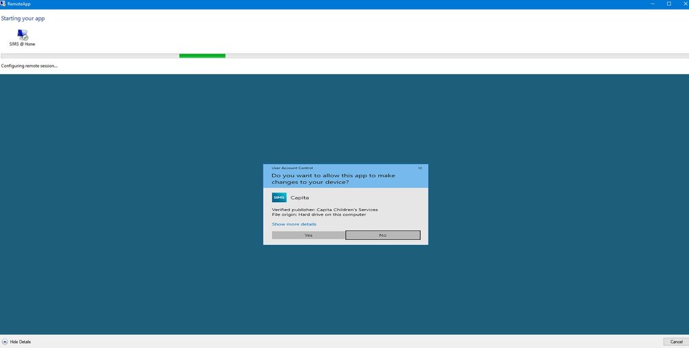

Been playing with compatibility settings on the app to see if it makes any difference. If I change to XP SP3 it seems to load minimised but clicking the app opens fine no white box. (haven't tested at home yet)
The only issue is you get a UAC prompt before SIMS opens.
Obviously I need to test at home.
