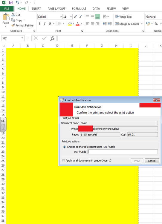

I feel I'm going mad here, but can't for the life of me work out what's up with this.
We've recently had a new set of MFPs replace our old ones so thought it was a good time to upgrade Papercut to, and we seem to have some random issues that I've never seen before and can't work out what's up.
Cost wise we have B/W 1p and Colour 5p as standard, Yet when printing through different programs to the same queues it's working it out as a different colour.
As an example:
Print Excel with 1 Yellow Box to Colour Print should be 5p yet is 1p and shows as Grayscale:
Print Excel with All Yellow Box to Colour Print should be 5p yet is 1p and shows as Grayscale (thought it might be some weird % of coverage detection):
Yet Print One Black Text/Word in Word to Colour Printer and it agrees it's colour (as expected as it's that printer) and charges 5p:
Am I going bonkers or shouldn't they all be 5p and all detected as Colour? Not sure why a different program is working it as a different costing etc

We have it setup as two seperate printers from how it was before I joined, rather than the scripted detection etc. So the two printers are setup, B/W auto'd to grayscale, Colour on Auto Detect etc. So even the text when sent to the colour printer is "colour" for all purposes, that's why I'm confused what's hapepning.
The colour aren't backgrounds even things like Cell shading in tables doesn't trigger it in certain programs it seems. Will have a better dig into Excel settings to see if we have anything else like that, but sure it never did this before the new printers :o Will double check that in case I did something silly in the settings for those programs!

Well after a lot of abuse at print drivers it seems to be an Excel thing that's just dumb beyond belief :p
https://support.microsoft.com/en-us/help/2526211/print-options-in-excel-are-applied-per-worksheet
Basically if your default printer is set to B/W when you open a worksheet, it'll pull those settings across even if you change printer to colour...
So B/W Default = B/W print whether B/W or colour printer selected only when using Excel, Set Colour as Default before opening Excel and it'll print in Colour.... Swear it never did this before even though it's "normal" according to MS....

Sooo... basically it's windows being stupid! After a very long and annoying search and destroy we found the issue.
Apparently there's an issue with using printer names over 31 characters long (including server names, slashes and spaces etc) and a lot of programs who use devmode truncate the printers names above that. So if you have a name like FollowMePrinting Colour and FollowMePrinting Mono etc etc it'll cut anything over 31 chars, and then if they match it won't swap settings when you change between them!
Shortened the names of the new printers and magically all works again! :frusty:
