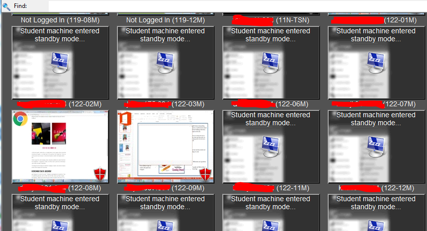

After a couple of restarts all computers in the rooms are connected but a lot are losing connection and entering standby mode, this is happening at random. For example a teacher can be viewing and remote controlling a student without any problems and then the console will report that the student has gone into standby mode when they clearly haven't! Any ideas?

If the machines are randomly flicking between Active and Standby, it would indicate that the status packet is being periodically dropped; the request is going out but not coming back. As the Teacher doesn't receive a response, it assumes the Student is in Standby.

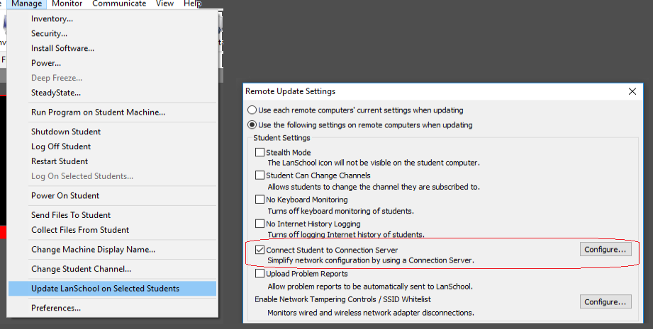

If your GPO's run on machine bootup then you can test it by booting up all the machines in a suite (if they're not already on), authenticating them if needed, and then doing what you need to do in the Tech Console. There is no machine reboot requirement for this; you can do it all in one session;
Manage > Update LanSchool > Disable LCS (Teacher and Students)
Replicate the issue
Manage > Update LanSchool > Enable LCS and enter server IP

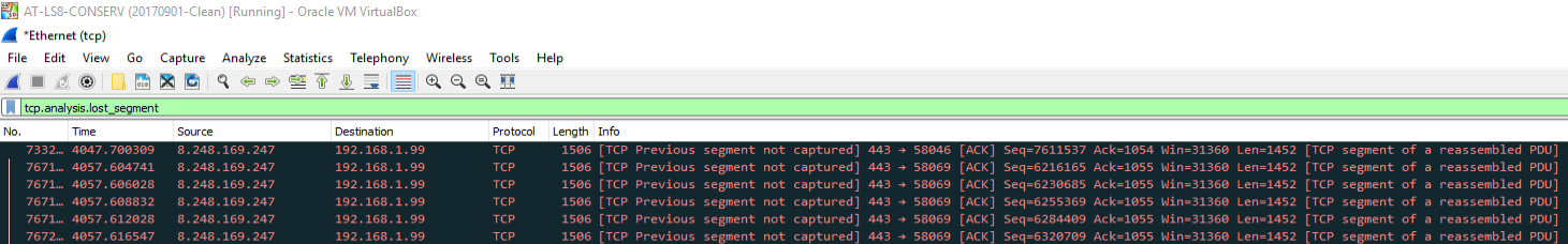

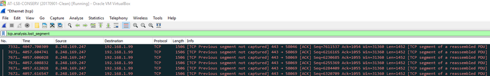

Wireshark will show you dropped/broken/corrupted packets (marked in black) if you use the filter tcp.analysis.lost_segment but this might end up being a rabbit hole (as you would have to run traces on the Teacher, the LCS and the Student, and then compare them).
