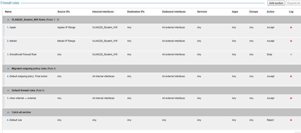

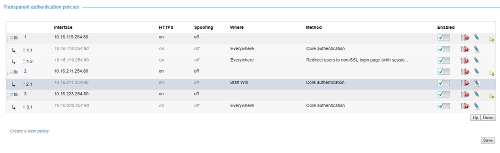

Here are my Transparent Proxy
Firewall rules.
Why is ethD plugged in?
It will act as the DG for Vlan220 which according to Smothwall is the cause of your issue.
Alternativly in the DHCP for the zone set the D-Link vlan 220 IP as the DG.
