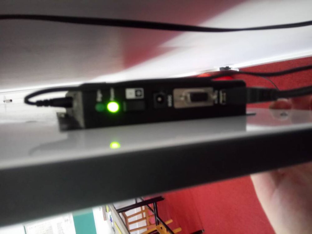

Currently, I've changed the USB Cable to a 1m length cable to ensure that it's not exceeding 5m, ensured the power supply is working and is powering the control box on the rear of the board, tried connecting it to a laptop even with USB 3.0, tried various versions of the software etc. But no matter what I try, I cannot for the life of me get the program to detect the whiteboard and use the board.

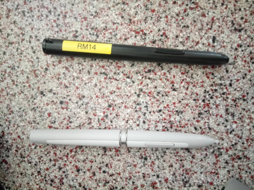

I'm also having difficulty trying to find technical support for this board and any information to see if the boards support touch, and that I'm using the correct type of pens.

Finally, I wondered if this type of board had a particular model number assigned to it? I can't see anything on the rear, and it's just referred to as a Hitachi Cambridge - yet there's a distinct lack of support or results that appear when I try to get any information on search engines.DSC_0250.JPGDSC_0249.JPGDSC_0248.JPGDSC_0247.JPGDSC_0246.JPG

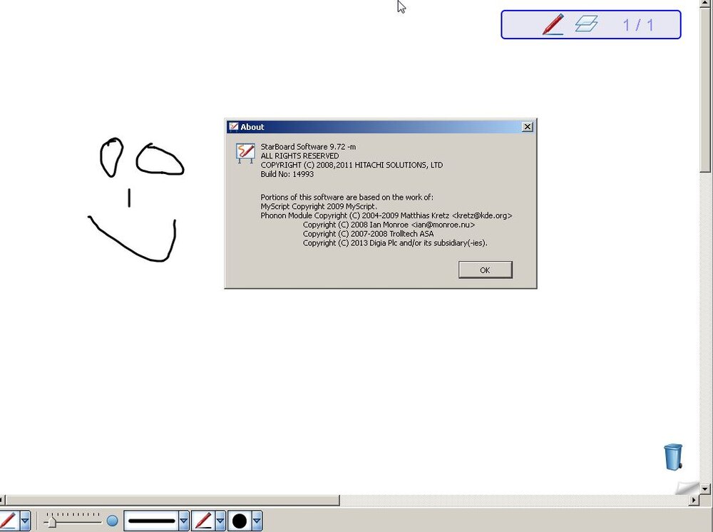

I'll give that a go - the guy at Hitachi sent me the link to version 9.72 - so even their website isn't consistent and hosting the latest version!

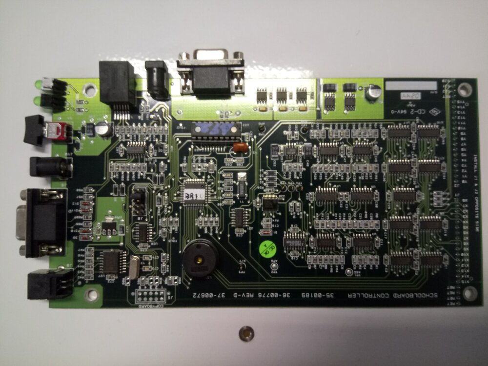

I tried another identical board this morning from the classroom next door and it worked perfectly! therefore I think the fault is with the board itself or possibly the circuit board behind and attached to it.
I disconnected the circuit board and had a look thinking that perhaps the solder from the USB could be detached and/or degraded but it all looks OK - I'm now trying to locate a supplier for these spare circuit boards, or if the price is to much I'll just purchase a second-hand SMART board.
