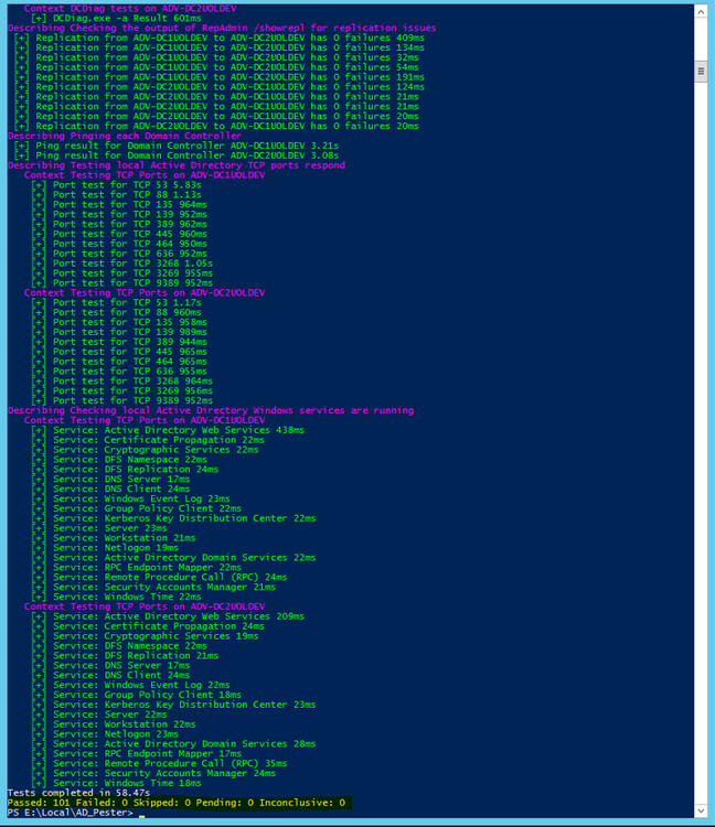

the following is a screen from a pester test that I wrote for testing the state of DC's and AD and is what it returned in my dev environment
The code for the pester is here:-

                       $Svc = get-service -ComputerName $DCToTest $_
                           it "Service: $($Svc.DisplayName)" {
                               $Svc.status | Should be 'Running'
           $DCToTest = $null
The pester relies on a script that I found on GIT and is as follows:-
[cmdletbinding()]
Param($ExportToXML = $True)
Import-Module ActiveDirectory
#HashTable to save ADReport
$ADSnapshot = @{}
$ADSnapshot.RootDSE = $(Get-ADRootDSE)
$ADSnapshot.ForestInformation = $(Get-ADForest)
$ADSnapshot.DomainInformation = $(Get-ADDomain)
$ADSnapshot.SchemaVersion = (Get-ADObject (Get-ADRootDSE).schemaNamingContext -Property objectVersion)
$ADSnapshot.DomainControllers = $(Get-ADDomainController -Filter *)
$ADSnapshot.DomainTrusts = (Get-ADTrust -Filter *)
$ADSnapshot.DefaultPassWordPoLicy = $(Get-ADDefaultDomainPasswordPolicy)
$ADSnapshot.AuthenticationPolicies = $(Get-ADAuthenticationPolicy -LDAPFilter '(name=AuthenticationPolicy*)')
$ADSnapshot.AuthenticationPolicySilos = $(Get-ADAuthenticationPolicySilo -Filter 'Name -like "*AuthenticationPolicySilo*"')
$ADSnapshot.CentralAccessPolicies = $(Get-ADCentralAccessPolicy -Filter *)
$ADSnapshot.CentralAccessRules = $(Get-ADCentralAccessRule -Filter *)
$ADSnapshot.ClaimTransformPolicies = $(Get-ADClaimTransformPolicy -Filter *)
$ADSnapshot.ClaimTypes = $(Get-ADClaimType -Filter *)
$ADSnapshot.DomainAdministrators =$( Get-ADGroup -Identity $('{0}-512' -f (Get-ADDomain).domainSID) | Get-ADGroupMember -Recursive)
$ADSnapshot.OrganizationalUnits = $(Get-ADOrganizationalUnit -Filter *)
$ADSnapshot.OptionalFeatures =  $(Get-ADOptionalFeature -Filter *)
$ADSnapshot.Sites = $(Get-ADReplicationSite -Filter *)
$ADSnapshot.Subnets = $(Get-ADReplicationSubnet -Filter *)
$ADSnapshot.SiteLinks = $(Get-ADReplicationSiteLink -Filter *)
#Export to XML
If ($ExportToXML -eq $True) {
   $ADSnapshot | Export-Clixml "E:\Local\AD_Pester\ADReport-$(get-date -format yyyy-MM-dd).xml" -Encoding UTF8
   Return $True
}Else{
   Return $ADSnapshot
To run the tests and I used the following invoke-OperationValidation available from here:- https://github.com/PowerShell/Operation-Validation-Framework (Invoke-OperationValidation -testFilePath E:\Local\AD_Pester\ -IncludePesterOutput | export-csv .\ADTestResultsPreSchemaUpd.csv)
Using the ADreport that the second script creates the tests are run against you DC/ AD configuration, the idea behind this is that I was able to test a lot of individual settings and check a lot of log files and the like after each step of the upgrade process. If you do not update the ADReport you can the see what has changed after each step as these will be marked as failed tests.
oh and this is useful:-
A way of just holding back a new DC from becoming a fully functional DC in a domain, gives you some options around testing your apps/ clients and the like before letting it go wild in your Domains :-
$DataValue = "Dc","Pdc","Gc","GcAtSite","GenericGc","GenericGcAtSite","GcIpAddress","Kdc","KdcAtSite","Ldap","LdapAtSite","LdapIpAddress","Rfc1510Kdc","Rfc1510KdcAtSite","Rfc1510UdpKdc","Rfc1510Kpwd","Rfc1510UdpKpwd"
New-ItemProperty -Path "HKLM:\SYSTEM\CurrentControlSet\Services\Netlogon\Parameters" -Name DnsAvoidRegisterRecords -Value $DataValue -PropertyType Multistring
Restart-Service -Name Netlogon
Hope some of this will help.
