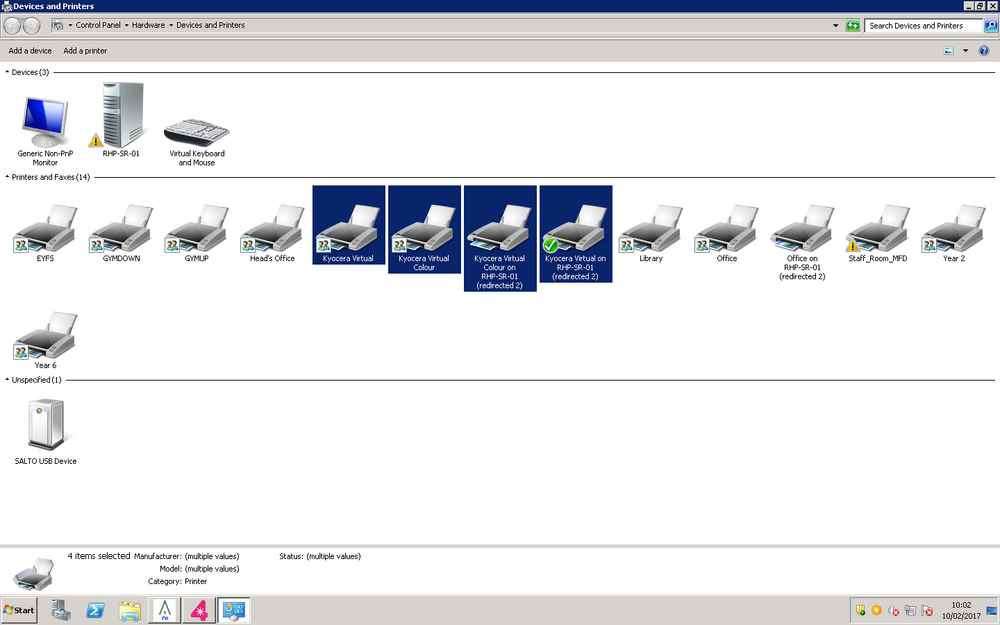

@Big_Ted, I have that turned off on Kyocera Virtual and Kyocera Virtual Colour, I cannot on the 2 "redirected" ones as the options are greyed out, Advanced Printing Features are both ticked but greyed out!
Any idea why I am getting the "(redirected 2)" printers for the 2 virtual queues and Office on RHP-SR-01 (redirected 2)?

Advanced Printing Features is EMF spooling which is how the color job is getting into the print system from the laptop. The (redirected #) indicates that the printer is a redirected printer in a Remote Desktop connection scenario. Redirected printer settings typically cannot be changed due to the security setting when the redirected printers are added to the Remote Desktop system.
Are the print jobs releasing to shared printer on another server? Are there conversion or watermarks in this configuration on the color printer. These are not supported for EMF spool files.
Don't worry about them they are just been pulled through from your PC when you RD to the server.
