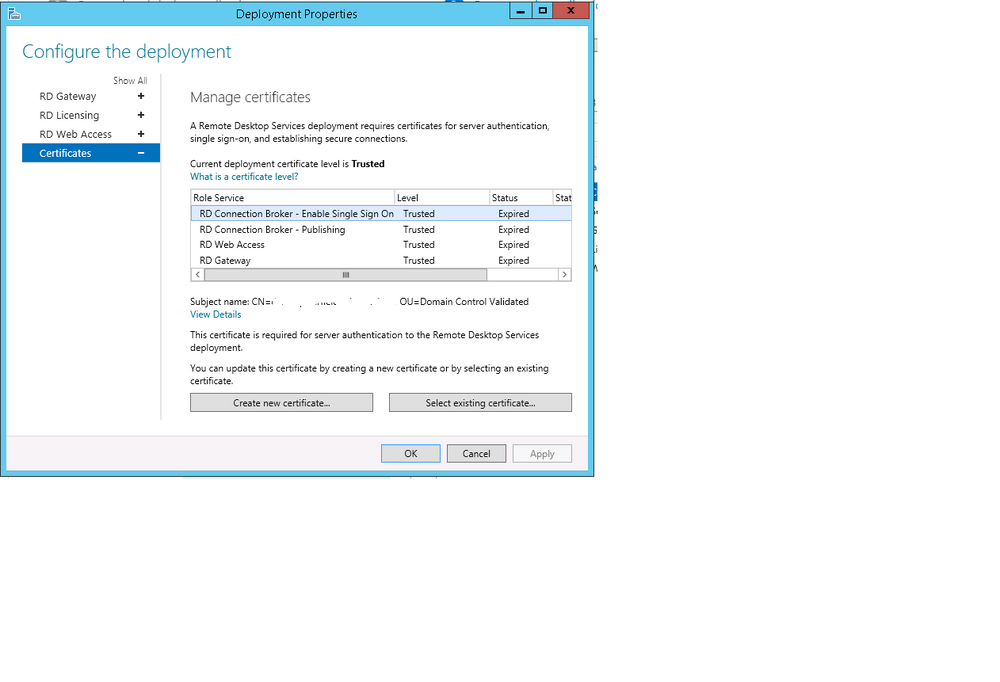

If I do the RDP externally I get: The remote computer could not be authenticated due to problems with its security certificate. When investigating, On the RDP server- server manager- Remote desktop services-Tasks- Edit deployment services- Certificates-Manage certificates window- Please see the snapshot it says:
RD Connection Broker- Enable single sign on – Expired
RD Connection Broker- Publishing - Expired
RD Web access – Expired
RD Gateway-Expired.
So I clicked choose a different certificate and when I browse to the desktop where the new SSL desktop.parkview.wales.sch.uk. crt is located and it is looking for a DER Encoded binary X.509(*.pfx) which doesn’t exist.
Please let me know how if I am missing anything and how to sort this.

Hi,
I wouldn't worry about .cer or .crt
The issue is you are unable to import the cert using the RD manager - because you don't have the private key in the bundle.
A pfx contains the cert, chain and key together in a bundle.
The key will be on the server you made the CSR on.
Another way of doing it might be to look in the cert store you imported the new cert into, it should say whether or not you have the private key - look for this - [Windows] Certificate With A Private Key Photo by jpaugh64 | Photobucket - if you can find this and it confirms you have the private key you can export it directly into a pfx.
