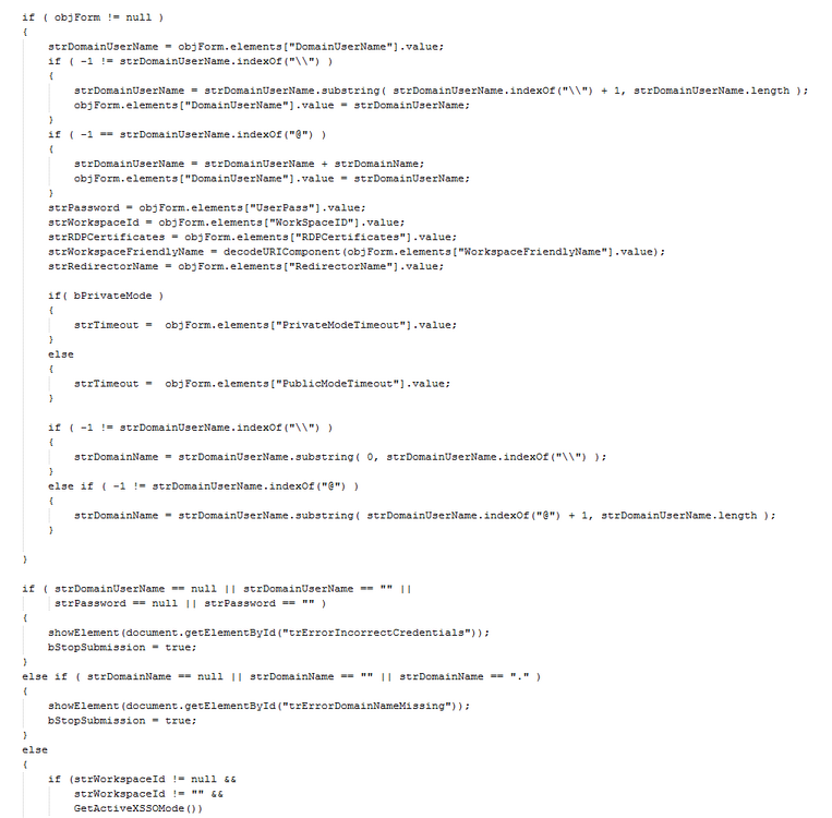

This is apparently not the behaviour for all clients. My clean Win10 test environment was fine, but then a colleague's Win7 school laptop didn't like having e.g. "GREENABBEY\[email protected]" as the username and would prompt twice without accepting the latter, so I've now corrected for this too.
In webscripts-domain.js, just above the previous edit beginning with if ( -1 == strDomainUserName.indexOf("@") ), insert this:
if ( -1 != strDomainUserName.indexOf("\\") )
strDomainUserName = strDomainUserName.substring( strDomainUserName.indexOf("\\") + 1, strDomainUserName.length );
objForm.elements["DomainUserName"].value = strDomainUserName;
So that section of the code should now look like this:
strDomainUserName = objForm.elements["DomainUserName"].value;
strDomainUserName = strDomainUserName + strDomainName;
strPassword = objForm.elements["UserPass"].value;
This should ensure that, regardless of whether the user enters "username", "GREENABBEY\username" or "[email protected]" for the initial sign-in, it will go down as "[email protected]" and should work fine! :)
Edited by Ephelyon
