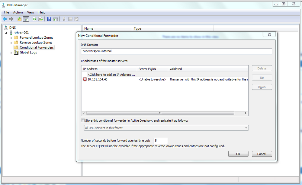

coreykeeling Posted January 6, 2017 Author Posted January 6, 2017 Assuming they are on separate domains, you can create conditional forwarders in DNS. You then specify the DNS name of the remote site and the IP address of their DNS servers. You can then RDP or whatever using FQDN's. Thanks FN-GM I thought I could use that or forwarders. I am now experiencing a issue when creating the conditional forwarders that it doesn't resolve the domain name and I get the following message "the server with this IP address is not authoritative for the required zone?"
FN-GM Posted January 6, 2017 Posted January 6, 2017 You can't really use forwarders as you will need to do it on both sides and you will create a loop and then nothing forwarding off to the public DNS. Where do you see that?
coreykeeling Posted January 6, 2017 Author Posted January 6, 2017 You can't really use forwarders as you will need to do it on both sides and you will create a loop and then nothing forwarding off to the public DNS. Where do you see that? I see the error when creating a conditional forwarder as you suggested.
FN-GM Posted January 6, 2017 Posted January 6, 2017 I assume that IP of their DNS server is correct? If so I would try it anyway and check that save in AD checkbox. Thanks
coreykeeling Posted January 6, 2017 Author Posted January 6, 2017 I assume that IP of their DNS server is correct? If so I would try it anyway and check that save in AD checkbox. Thanks Yes it is correct. I have created the conditional forwarders on both sites dns servers and when I ping using a hostname it says it can't find it and when I use nslookup I get the following error like it isn't even looking at the other dns.
FN-GM Posted January 6, 2017 Posted January 6, 2017 You need to ping using the FQDN. eg: trp-sr-001.domain.local 1
