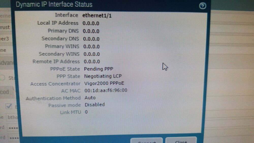

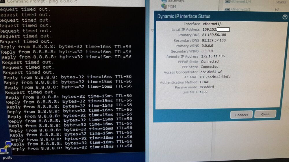

Am so close to getting this working with my BT Infinity connection. The Firewall is a PaloAlto VM series running on ESXi 6.0.
It works fine when using a BT OpenReach Modem.
But jus sitts at Pending PPP/Negotiating LCP when using the DrayTek. This is as close as I get with no changes made on the PaloAkto
Can anyone please post pics/screenshots of a working setup, I've tried so many online docs it's not funny.

Yep I tried that too but don't even get as far as getting Access Concentrator info.

It is yes, a 2860. I bought one not thinking of doing a simple pass through but don't really want to sell it and buy a Vigor130. So that's why I bought the OpenReach cheap off ebay. When I look in the status on the DrayTek it gives no indication that it is connected. It showed a status of Training I seem to remember.
