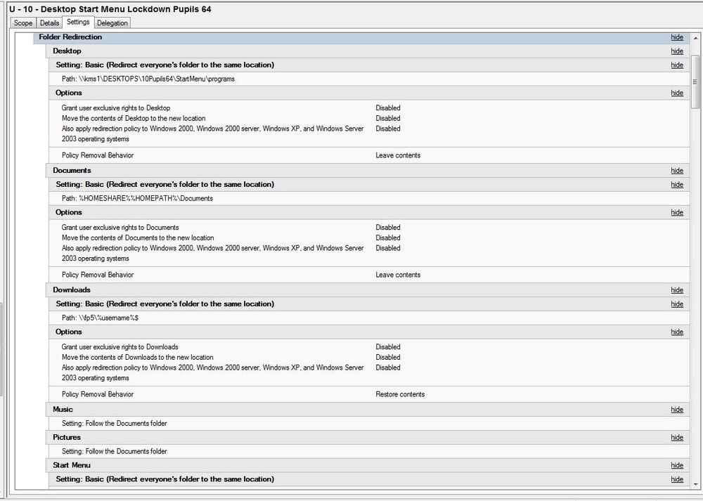

Have you got 'leave contents' under policy removal behaviour?
[ATTACH=CONFIG]40038[/ATTACH]
Yes, and I've checked these are all the same settings for Windows 7
I noticed this when testing on W7 the other day, and I had leave contents set too so I assumed this is why its leaving the start menu when the policy is removed. I found if I removed the users local profile it reverts to the standard local desktop.
OK so seems I was wrong about windows 7 :(

If you change the removal behaviour to redirect to the local user profile, presumably it will revert to the local one, although I havent tested yet.
Thanks,
I just edited the policy to :
But when I disable the policy the desktop remains redirected :(
Thanks,
[ATTACH=CONFIG]40043[/ATTACH]
Hmmm now that is unexpected. Have you linked it again but maybe to a user that hasnt had the policy previously applied? It would be interesting to see how that behaves.

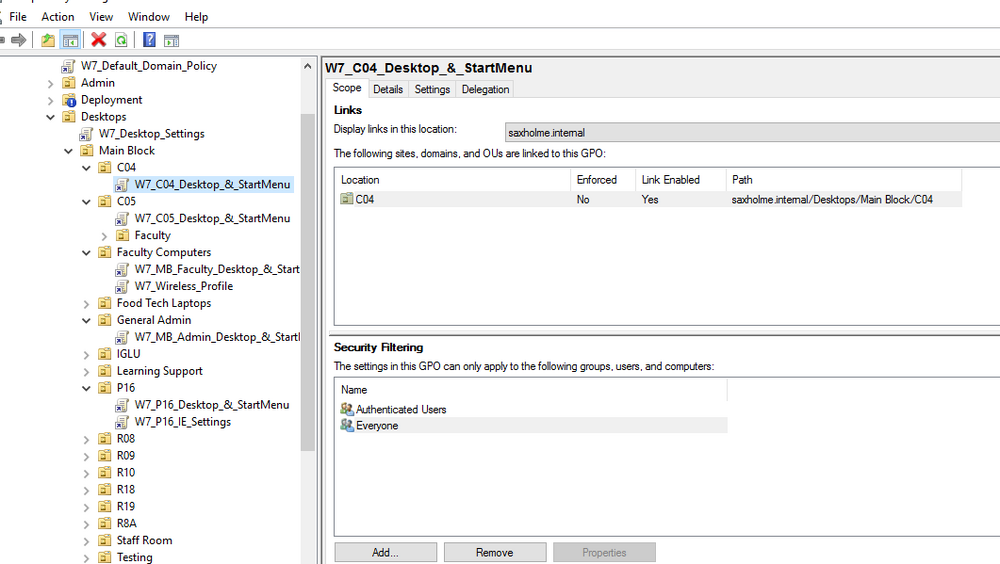

Apply the redirection to the computer OU you want redirecting. I use AD groups and assign the redirection based on being a pupil or staff member. Capture.PNGCapture.PNG Edited by DavetheITguy
Apply the redirection to the computer OU you want redirecting. I use AD groups and assign the redirection based on being a pupil or staff member. [ATTACH=CONFIG]40045[/ATTACH][ATTACH=CONFIG]40046[/ATTACH]
Oh I see.
I've not done it that way.
I apply the redirection policy at the User Level, which when I set it up made more sense...so no matter where students or staff logon - they get redirected.
Why does it make more sense to apply this policy at the Computer level?
I apply it to the OU so it only affects the computers in that OU. I use AD groups to apply different desktops and start menus to staff and pupils. It's pretty much live as well if I add a link it appears instantly on the desktop or start menu. I have structure to my desktop and start menu redirection,
main block > room > Staff > Desktop
main block > room > Staff > Start Menu
main block > room > Student > Desktop
main block > room > Student> Start Menu
Ad groups are connected to this so if they are in student group they will only get a student redirection.
I've also done it this was as certain rooms have specialist software that others don't. It looks nice if they don't have unavailable links showing.
