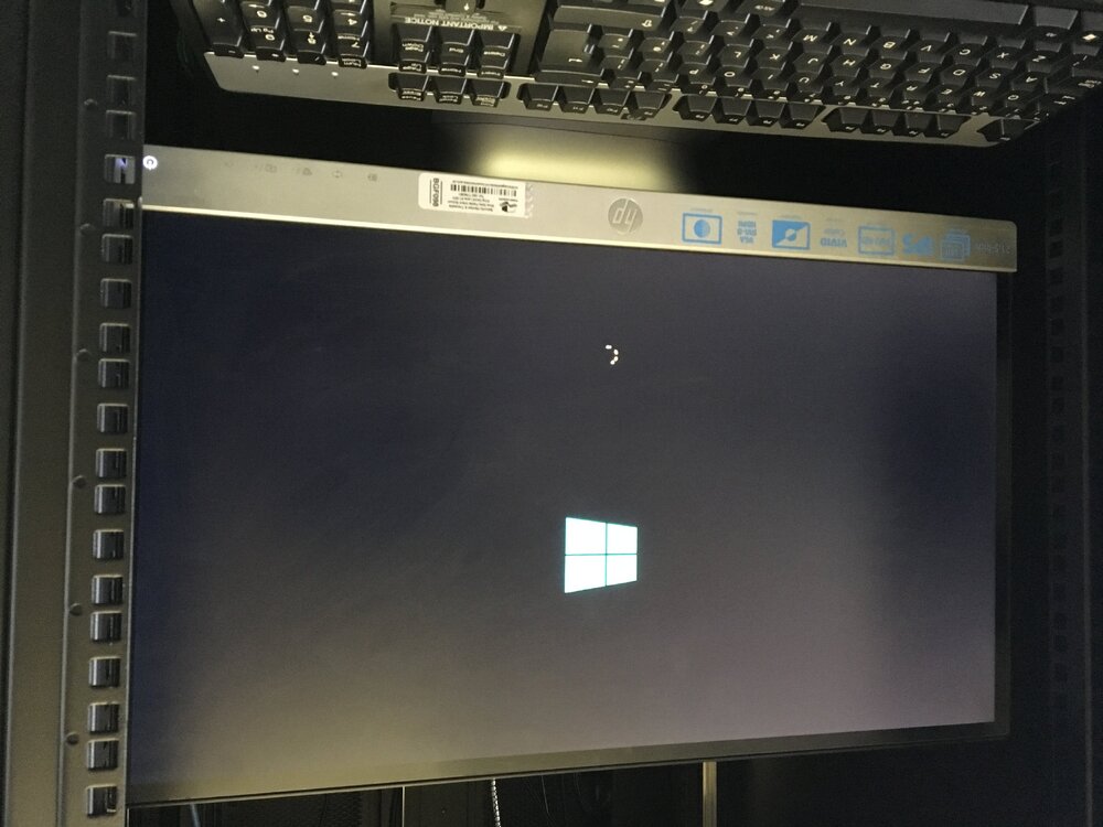

Ok, I have got a problem.
Server installed perfectly, as soon as I added Hyper V via server manager and the server rebooted, it went onto an endless bootup process. It just does this for hours and hours and never changes...
I assumed it could have been a one off fault, so I re-formatted, re-raided in raid 5 and went back through the HP provisioning to install Server 2016 Data Center. Again, it worked like a dream, but as soon as I installed Hyper V, it went back to the same problem as above with the screenshot.
What could be the problem here?

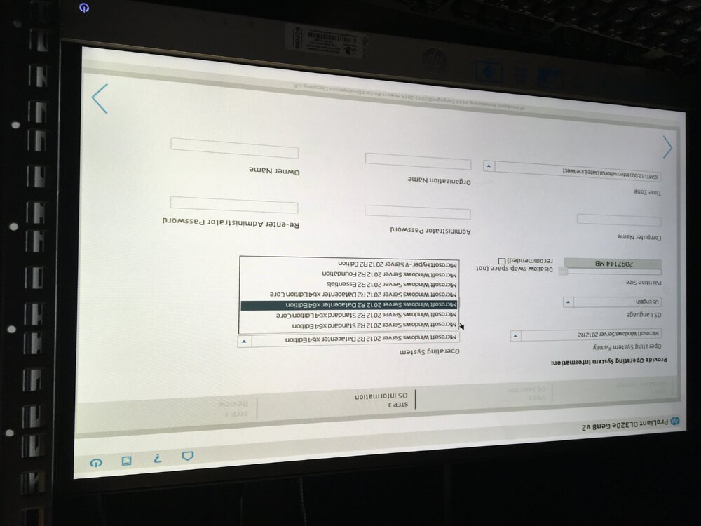

The only thing I noticed during setup which caused me slight concern was that Server 2016 was not listed in the provisioning drop down, so I selected the next best thing.

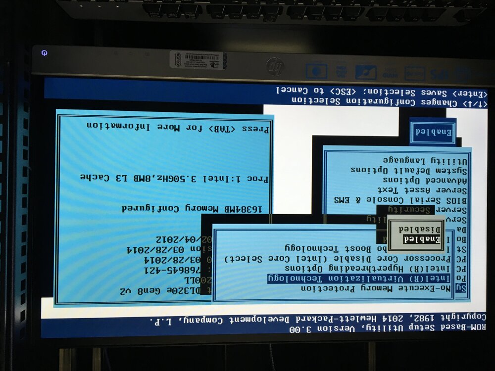

Have you checked if Intel Virtualisation is turned on in BIOS?
Yes, I was sure it was on and it is switched on the BIOS

Bad news... installed without intelligent provisioning.
Installed well with no problems. But again, once I installed Hyper-V, it stalls at bootup.
