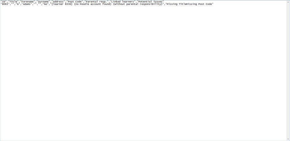

If you open it in Word, and turn on special characters what's it show? (The little icon next to AZ sort button normally)
Steve
This....
And this output is from a routine we run to validate parental contacts on our Moodle VLE.
Aye that linebreak after Missing Title will cause you the problem. Calc ignores them when it's doing it's import.
If it's always starting with "missing" for the issues.
Open it in word, turn on special chars and do a find and replace -
Replace ^pM with " M" (space M not ")
Will bring all the Missing Parts to the same line, at least for the test example :p
Steve
Steve
