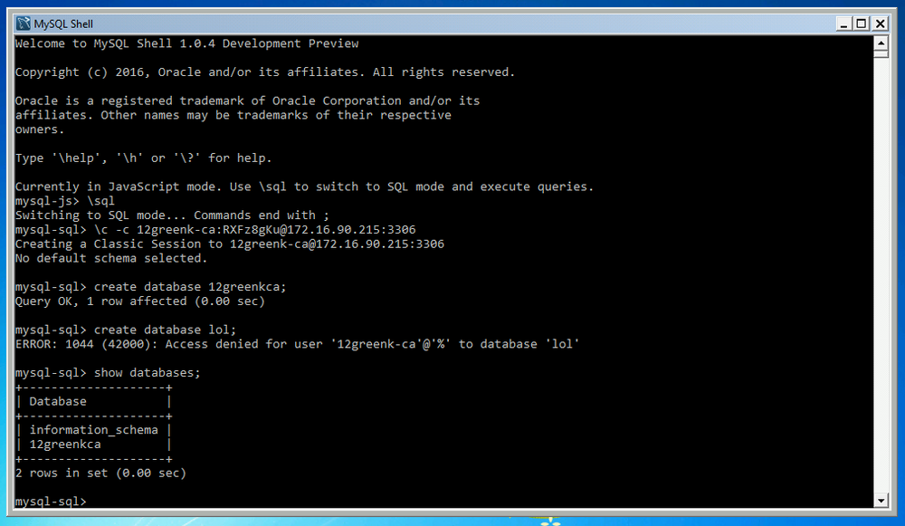

After launching MySQL Shell, the command to connect to remote instance in sql/classic mode:
\sql
\c -c username: password@serverip:serverport
From this point it is just normal sql commands, no command prompt access required.

Thanks to everyone who has contributed to this thread as I have been able to follow most of it with never having used SQL products before. I have it working where users can connect from any workstation that has MYSQL shell installed to the MYSQL server and can create their own database without seeing or having access to any other database.
I am now in the same position as FN-GM and I'm unsure how to get an sql file imported when using the MYSQL shell set in SQL mode using \sql and at the MySQL-sql> prompt. I can also inport the sql file if I use the MySQL.exe file.
Has anyone actually done this as I believe it will be part of the assessment for the pupils and like most other people we don't want to allow pupils access to the command prompt.
@cogrady84 thank you for the instructions and screengrab as this helped tremendously, although it looks as if there is a space after the : in your original posting which threw me to start with.
