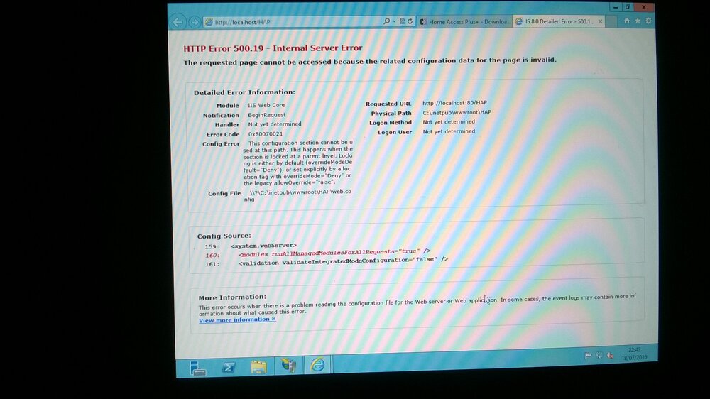

Did you remove the entries in the web.config that are not required as you have to remove some depending on which version of IIS your using so if your using IIS 8 then remove the following section from your web.config:
Hopefully that helps :)
If you go to the location of your HAP files you should see a file called 'Web' which will be your web.config (see below image):
If you open the web.config file in a text editor (notepad, notepad++ etc) you should be able to use CTRL + F to find the following line:
Once found delete the following section:
Save the file and I would also recycle the application pool and restart the site on IIS just to make sure the configuration applies correctly. You should find that HAP is now working once those changes have been made.

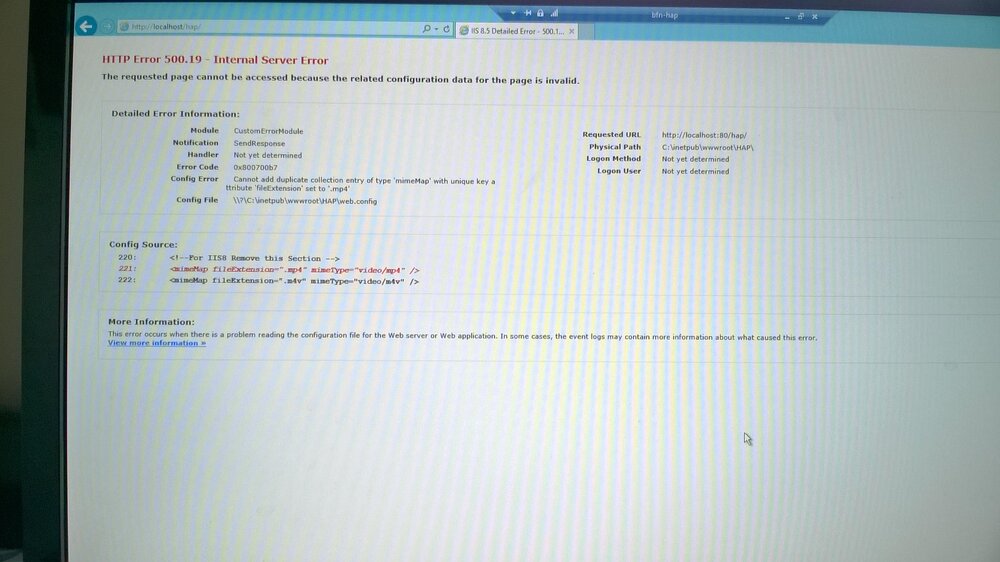

Hi Guys, After installing it on 2012 and refreshed the app pool and the web config file it is still not working. It is now asking me to do something else (see error message). Is this normal? Have i missed something? Its starting to get to me! WP_20160718_002.jpg
Update......

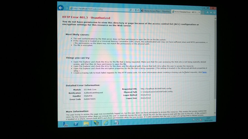

After removing the script highlighted in red above it now says there is an authentication issue. Any ideas?

Thanks, i will try this and let you know how i get on. I did try this but it refused to connect, it is mostly likely due to me not having an ssl certificate Edited by ITBlandster
The errors appear in http but i haven't tried it in https as it keeps saying "refusing to connect" when doing local host and through the ip, is this due to me not having an ssl certificate? At this stage i just want to test to see if it works. So if i ran it in https, will the issues (above) dissapear?

I set it up with https and haven't received any errors, I think it requires https.
