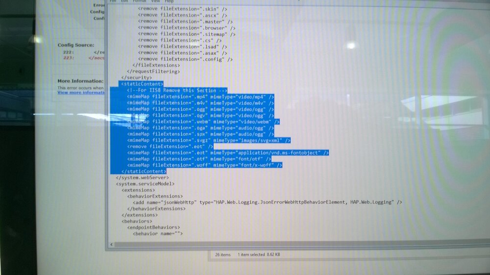

  6. Hello, Sorry about the delay as i was away. Thanks for that i will give it a go once i get past the config errors. I was wondering if you could help me as i'm still stuck in the same hole. Below are the pictures of me removing the section (so you can see if im removing the wrong thing) and the constant error message that is occurring. So i hope you can help me? Thanks Jordan
  7. can someone PLEASE attach the edited web.config file to this thread as i am really struggling here. thx
  8. do i have to delete the static content texts?
  9. Hello, Is there anyway i can change the home access plus front page logo to my school logo? and which section do i have to remove from the web.config file for iis 8? It would be helpful if someone could print screen and highlight it for me as i get easily confused what is what. Thx

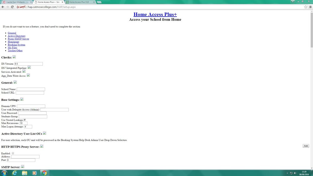

  14. The errors appear in http but i haven't tried it in https as it keeps saying "refusing to connect" when doing local host and through the ip, is this due to me not having an ssl certificate? At this stage i just want to test to see if it works. So if i ran it in https, will the issues (above) dissapear? Thanks

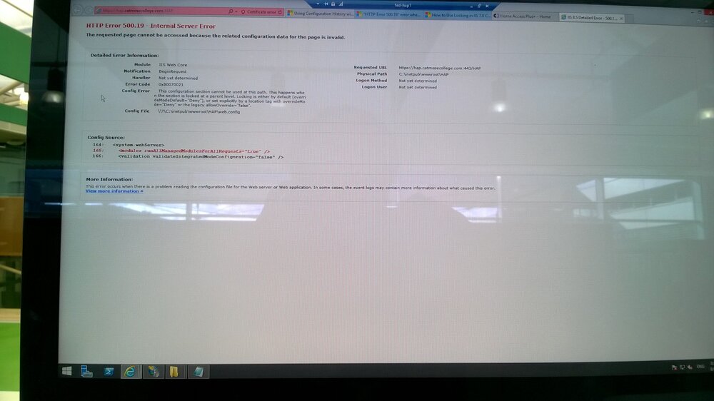

  17. Hi Guys, After installing it on 2012 and refreshed the app pool and the web config file it is still not working. It is now asking me to do something else (see error message). Is this normal? Have i missed something? Its starting to get to me! Update...... After removing the script highlighted in red above it now says there is an authentication issue. Any ideas? Thanks

  21. Hello, I keep getting this error message when i install home access plus V10 on Windows Server 2012 R2. Any ideas on how to fix it? Thanks Jordan
