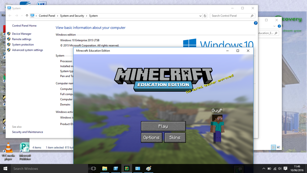

I can install it, well, on some computers, others randomly fail.
My question is: how do I deploy it. How do I make sure all computers have it for all users? Why isn't it a thing in GPO like MSI is?
Right... random question... why do you have to copy these files to the machines? Can you not just run them off a network share?
Might just set it to copy for the time being and then run the install in a few weeks.
