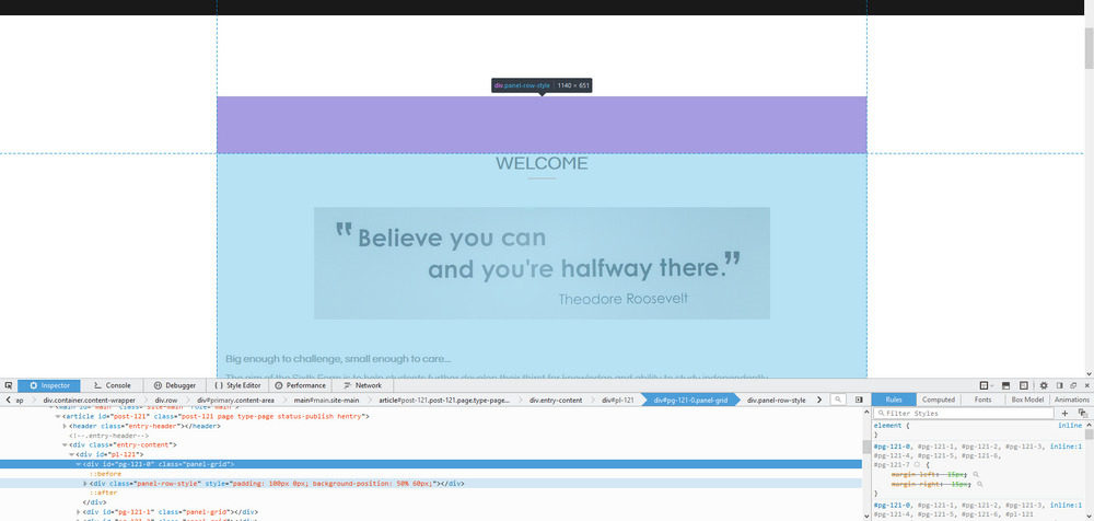

chrispounds Posted June 8, 2016 Report Posted June 8, 2016 Can anyone work out what i need to reference here to affect the highlighted area? Ive tried #pg-121-0 .panel-row-selector {}, #pg-121-0 div {} Just cant seem to grab it for manipulation, only want to change the padding values - sometimes WordPress is irritating... Attached an image
ijk Posted June 17, 2016 Report Posted June 17, 2016 From the image it looks like you want to target the block: I think the following will target it: #pg-121-0.panelgrid {}
chrisbradbury Posted June 25, 2016 Report Posted June 25, 2016 Chrome inspector handily tells you the exact selector you need when you click on it. So div#pg-121-0.panel-grid{} will directly target that specific div
