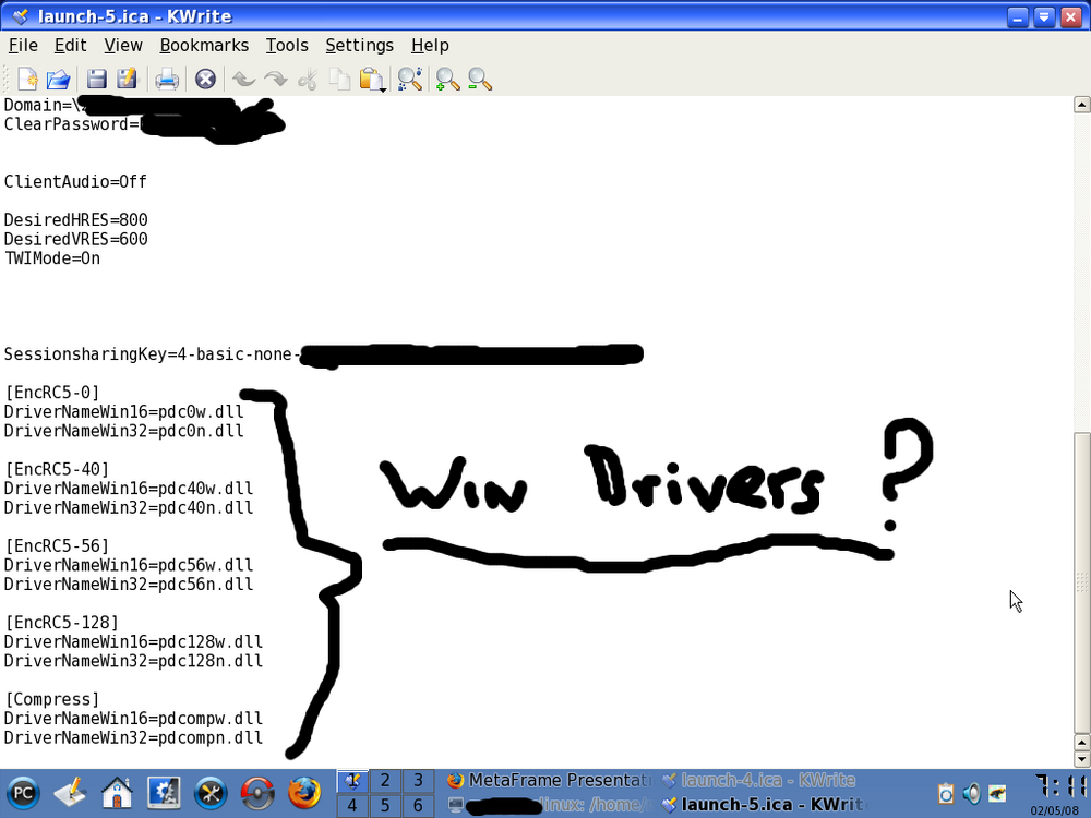

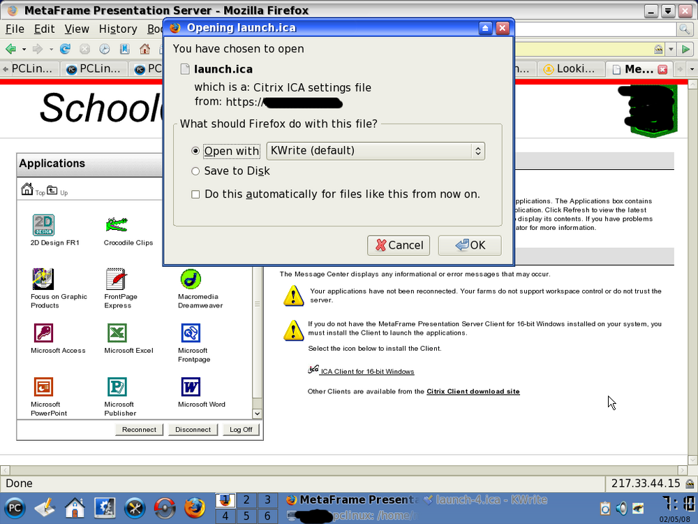

When I come to test the connection, I can log to the homework web site, click on say.. 'Word' , next the login details box, But next I get open with Kwrite (screen shot 1 ),

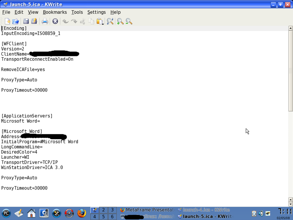

If I click ok I get the detail in the screen shot 2 & 3 .
Are those driver details for windows at the bottom on screen shot 3 ?, If they are will I have to get the school to add some Linux driver details .

Don't worry about the .dll's

I had the citrix connection to the school working.
From the menu box that comes up (Screen shot 1) I have told it to send to desktop and ticked the "do this each time box" it then puts 'launch.ica' on the desktop, I can then click on that and I have associated it with the 'wfica' part and it then opens up the program ok.
I need to get rid of the "desktop" stage, how do in set it so it opens when I first get the menu as Screen shot 1 ?.
How do I undo the 'do this each time box' ?

Got it working by, Downloading Firefox add-on 'Mime Edit'
Then I could delete the open with file connection I made (screen shot one) and re make with /usr/lib/ICAClient/wfica.
And It works each time now..:).
