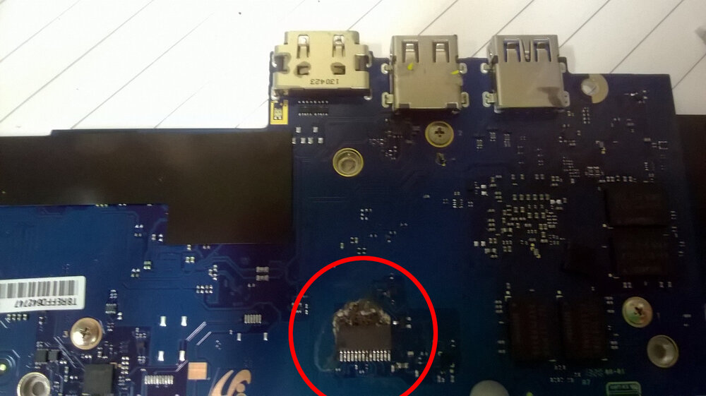

Just had 4 laptops handed to me that have been in a bit of water. I stripped 2 down and the boards have a few burns on them. Has anyone managed to source replacements for the Samsung CBs? Looking online and they are mostly in the US of A. With shipping and tax it becomes almost the same as a new one.
We've had a couple with water damage (not samsung). We've been able to salvage them *if* they've not been turned on, otherwise the boards need to be binned.
If you have enough of them the damaged boards can be replaced with machines that get damaged screens so my advice would be just to hang onto the parts unless you are able to get one with a broken screen for a reasonable price on ebay.
That looks more like corrosion than a burn, gently clean the area with IPA and a toothbrush.

So I have dismantled 4 and given them a good clean.. the stuff on the USB sockets looks like that stuff you get round car batteries when they leaked which is what I meant... has a very funny taste so don't lick it. :)
First one I got to boot up but says the OS is missing.. tried the recovery USB but says there is an error. The worst bit of the 'burn' on the board seems to be in the ribbon for the trackpad... although I removed the plastic heatpad and another chip was covered in black stuff
Second one doesn't show any lights when I plug in the charger, there is a bit of copper coloured metal showing next to the power connector on the board... not sure if its melted but I think that's the culprit.
Third one is drying out but I think the battery connector is bad
Revived the fourth one though, cleaned up the board and swapped the battery, the connectors on the battery and really black so will try and scrub all the crap out of them.
25% success rate so far.
You're still alive after licking the strange substance and 1 is working so that's a good start.
The chromebook that gives the OS error, is it the one in your first photo ? as that is the tmp module.
Unless it'd really cruddy i wouldn't suspect the battery connectors, it's more likely to be a shorted IC. MLCC are sensitive to water also and fail easily.
If you want to take photos of any suspect areas i can try to help further.
I can't find any schematics or boardviews but if you have a multimeter you can compare voltages etc with the working board to try and locate the dead parts.
