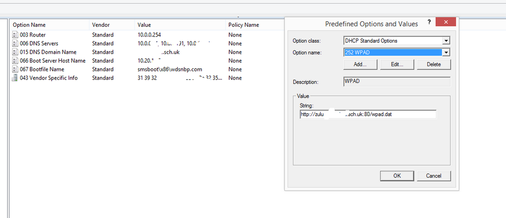

Currently trying to setup failover for our DHCP, but running into some issues (screenshot below)
I have visited https://social.technet.microsoft.com/Forums/en-US/a60ed600-58d6-4f06-a8c5-d01104b1eaa7/server-2012-r2-dhcp-failover-error-20010?forum=winserver8gen and tried the different options mentioned, but still does not want to work. We don't have any custom options and can't figure out why it is failing.
Anyone come across this?

Does your 2nd DC have all the same Custom Options set? e.g. Gateway/PXE servers etc? I know you said you have none but surely you must have something set in the options? :s

I had the same issue and the above was the problem. I am confident it will be this.
In the main server options under IPv4 there is nothing configured (just taken over the network and trying to straighten things out.) but under the scope options everything is configured there under that scope options, tried to create a scope on the partner server and filled out all the scope options, but when trying to replicate it won't work as it says already scope there (probably doing it wrong, so deleted it and tried again but same message.
Thanks,
Had a look and none are available for delete and the only one I can see that is different is 060 PXE Client which is showing as defined on the primary, but no option to add on the other servers options.
If it's in one it needs to be on both or none.
060 PXE is a powershell add though.
And it should show you the option to delete if it's a custom one (unless it's powershell to remove too), you sure you're looking in the options on the server and not scope?
Edit - Are you actually using 060 though? As just looked and we only have 066 and 067 for PXE/WDS etc
Steve
Edited by Steve21
Just added it, saw the button straight after I posted. Added the option 060 into the predefined on the other server and got it setup for the failover.
Thank you very much for your help and your offer :)
Haha cool :) Aye one of those stupid things isn't it, think by now it would actually give you helpful errors, as it has to check what exists on both yet won't tell you what doesn't! :(
