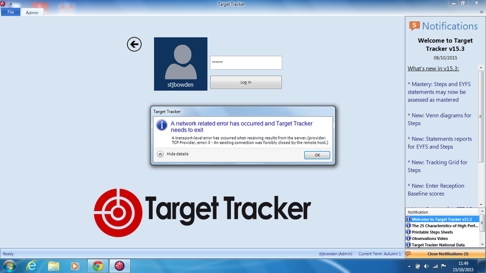

Have been struggling foe weeks now to get Essex Target Tracker to connect successfully within the school. Staff laptops when at home will connect but will not connect either on wired or wi-fi connection whilst in school. The TT connection test works fine and have updated to the latest version of TT (currently 15.3). The school classroom computers originally would connect to the TT server but now it is intermittent that they may or may not connect.
Anyone have a similar problem or a resolution to the problems that I am encountering?
The message I am getting is as per the screenshot attached:
As you can see connection is partially successful as the TT notifications are displayed but cannot connect to the data server/
Hoping someone may have some words of wisdom
Thank you. Jeff
I bet port TCP 1433 is blocked on the firewall.
Yer, looks like your have to contact your LA\ISP and ask for it to be unblocked. Believe the database backend is an Azure db.

Well "Forcibly closed by the remote host" is firewall. It could they have too many connections and its randomly picked on the machine. It could be its flicking between the wifi and the wired connection and it doesn't like that, it could be the firewall rule you have - only certain IPs are allowed. Could try pinging your router from the machine, see if you get any packet loss - if you do, you know you've got a faulty port \ wifi point.

A while ago Azure changed all of Target trackers IP's, we had to log a call to get the firewall rules updated. I think a couple of the IP's stayed the same as it would randomly connect.
