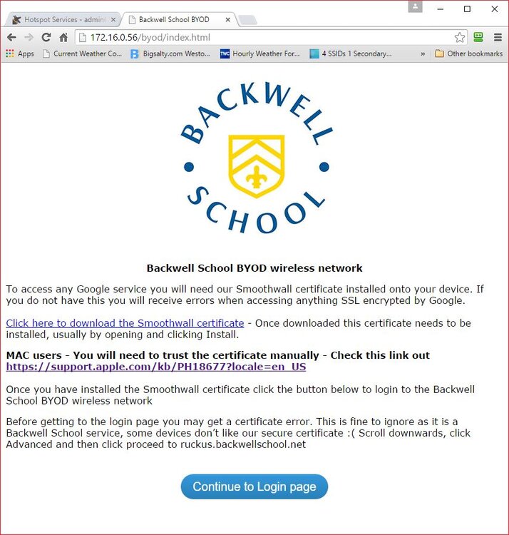

I have 2 SSIDs which i want to happen on. Once authenticated they are redirected to an internal page with the smoothwall MITM certificate which can be downloaded along with a few links to Home Access Plus and Papercut web print along with a few others.

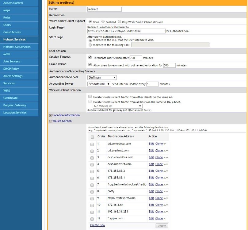

We do this a different way. We direct them to a page that has the cert on first allowed in ruckus without auth. Then there is a link at the bottom to the ruckus login. Someone else on edugeek gave me idea so can't take credit

What about mobile devices such as Android and IOS, do these need the certs installing too? Do you provide instructions on what to do with the certs on windows machines? I found when i installl the cert i have to select Local User and place it in the correct store as placing it in the auto-location i found doesnt work as it puts it in the intermediate Certificate store. Edited by timbo343
The trouble with the HotSpot service i had was, i couldnt get the hotspot to work with AD. Sorry, it was the guest access i couldnt get to work. The Hotspot service didnt work on some of my devices, god, ive changed that many settings today in Ruckus. Edited by timbo343

To answer a previous question we currently don't give detailed instructions for installing certs. Thinking I might need to
Ive just set this up on my ruckus box under a test SSID and I cannot get a windows 7 laptop to redirect me to the unauthenticated web page however my phone Android 5.0.1 works fine 0 it comes up and say need to "Sign in" and when I do it takes me to my internal landing page.

Found what was up... VLAN1 (main domain) doesn't push out a default gateway... now ive added a default gateway into the windows 7 laptop I go straight to the landing page :). Simples!!
but now im wanting to add something else to this. Once the user has authenticated I would like to push them to a site internally where they can access print / HAP shortcuts. Ive tried to add "After the user has authenticated redirect to: {the schools web page}" however all I get is null in the address bar.
Have you got anything that pushes them to another page once authenticated.
Interesting.. even if i dont set a URL redirect i get null.. however if i give my phone, Android 5.0.1, an ip address i dont get a ruckus login screen or directed to the authenticated page.
Not made much progress with this today. I have managed to get the Post16 wireless to use the unauthenticated page - a bit like yours but trying to apply this to the staff one and it doesn't work... I get a smoothwall login box instead of the page even though ruckus is using the same hotspot policy and has all the same zone bridging entries as the post16 vlan and the authentication is the same under web proxy. I don't understand why I'm getting the login page for smoothwall.
