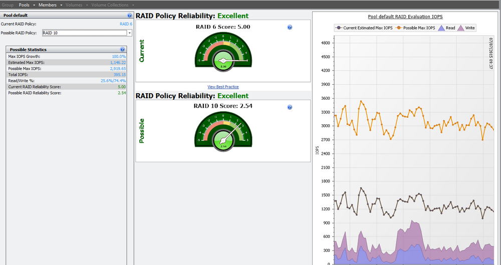

The consultant has told me that DPACK reported 1,168 IOPS on the 95th percentile and peaking to 1,700 IOPS on the 99th percentile.
Apparently the SAN they have recommended is capable of just over 5000 IOPS which is why they've recommended it.
How much are you paying for that SAN? We don't get near 5k on ours.
I mean a 10K SAS is maximum what 150~ IOPS, so even 24 would only be 3.6k without taking hotspares etc into account
Steve
Just checked on ours. 24 disks at 10K
Gives us 1146 IOPS (RAID 6), if we used RAID 10 would be 2919
So again going to depend what you're configuring yours as, as even 24x 10K SAS would be struggling if you're RAID6
Steve

The SAN they have quoted us for is a Dell Equalogic PS4100 containing 12TB of Nearline SAS disks configured as RAID 10.
It's about £7.5K.
I don't think you'll get anywhere near those figures unless I'm missing something. I'm assuming that's only 12 disks then too? 12x 1TB?
Even our 10K SAS doesn't get that IOPS in RAID10 config (and what 7.2K is roughly 2/3 IOPS?):
This is our PS4100 with 24x 10K SAS:
Steve
[ATTACH=CONFIG]31452[/ATTACH]
Steve
That is really, really useful. Many thanks for that.
