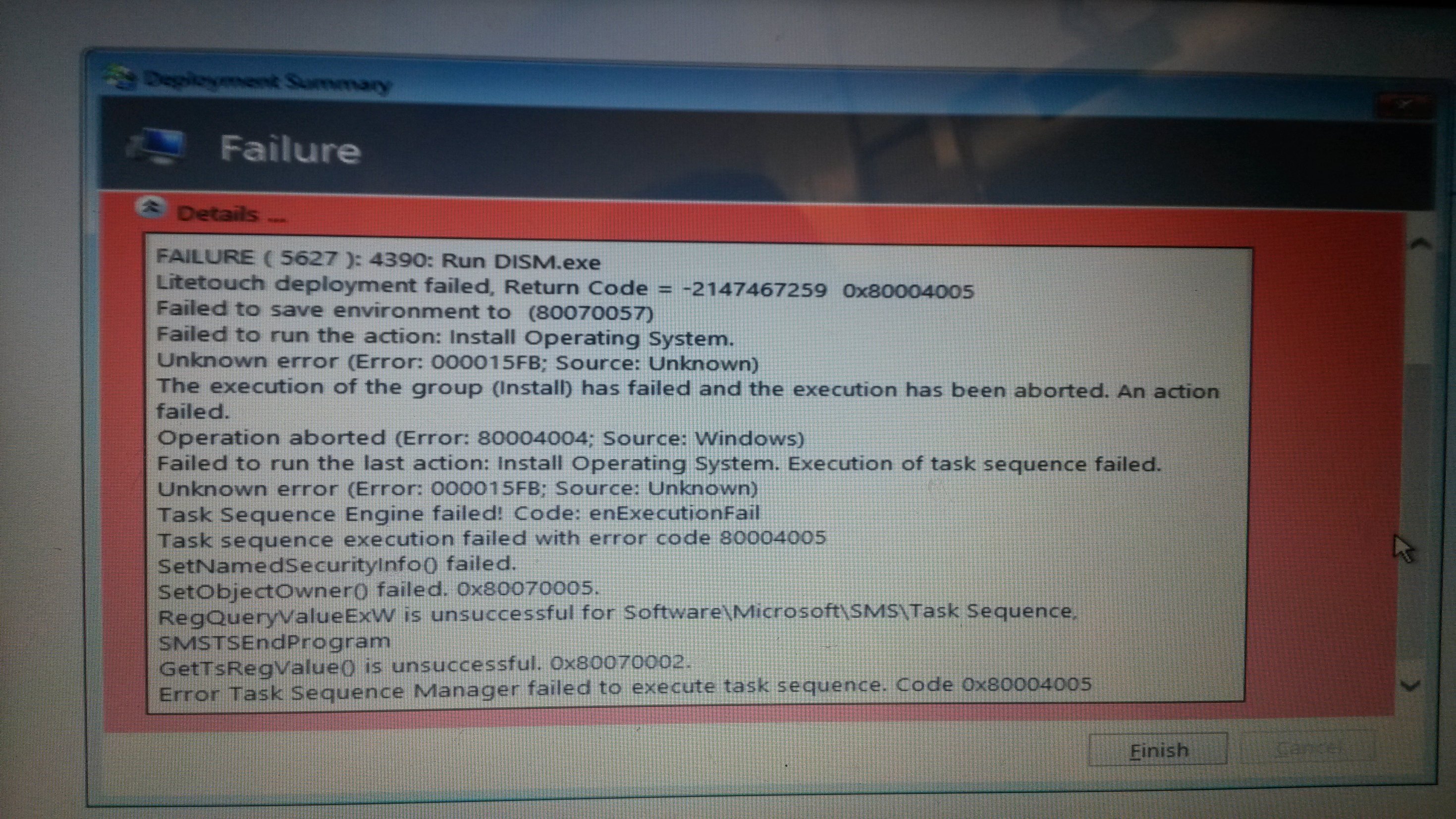

This is the error I am getting:
A google suggests it is the lack of a network driver. So I downloaded and attached it to the boot image. But its still doing the exact error. I have tried two different task sequences to make sure that was not the issue.

Ok, so I have managed, after 2 weeks of troubleshooting, managed to resolve it myself, 10 minutes after posting for help.. Typical.
Turns out it was a network driver missing. It looks as though my task sequence was just ignoring the drivers I had attached.
So I had to remove all my drivers and import them again into MDT. While I was at it, I tided up the structure too!
Next boot, I actually saw the drivers being imported one by one. Worked straight away!
