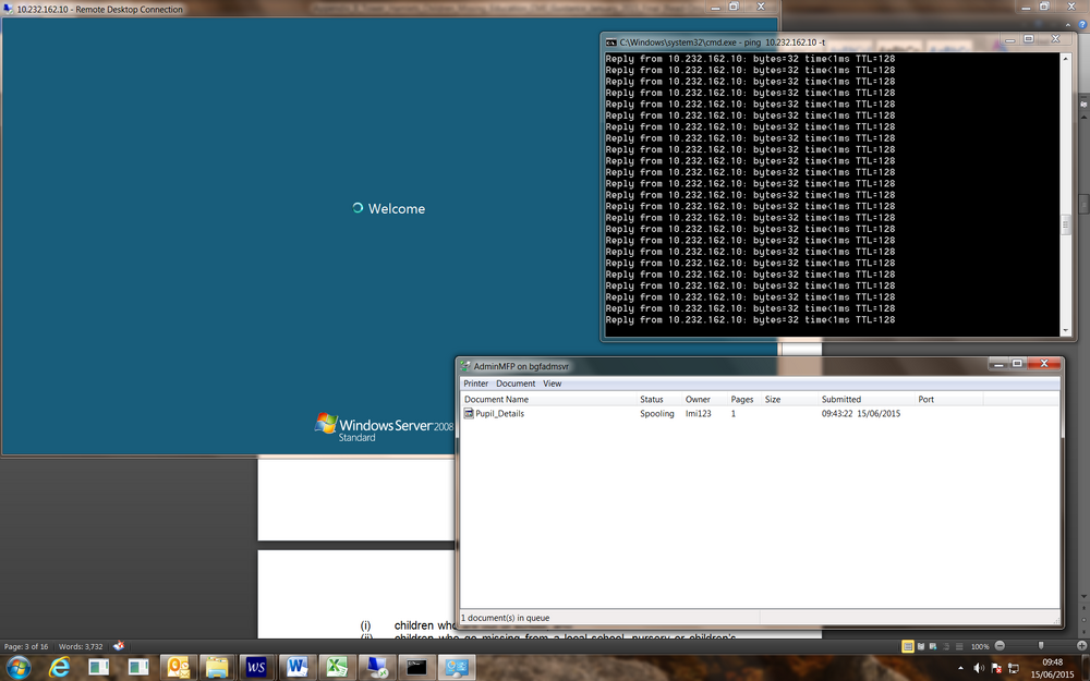

I have a really confusing problem here and would greatly appreciate any help.
I am running Server 2008 R2 with full updates etc.
Every so often, my users are reporting that they are unable to print documents and spooling is shown in the print queue.
We have established that it is any printer listed on the server. The printers are 100% not at fault.
When the error occurs, it can take up to an hour before the print queue clears and the job comes out.
It happened this morning, and what I found interesting was that I was still able to browse network shares on the server, ping it and open files, but could not print or open an RDC session. It took over an hour to get an RDC session as as soon as RDC worked, the print jobs started to come out of the printers.

I believe the reason for the printing problems is that the server is under resourced. When I finally connected, its ram was maxed out. Biggest process was BE running a overrunning backup.
New server time, as this one is about 7 yo.
