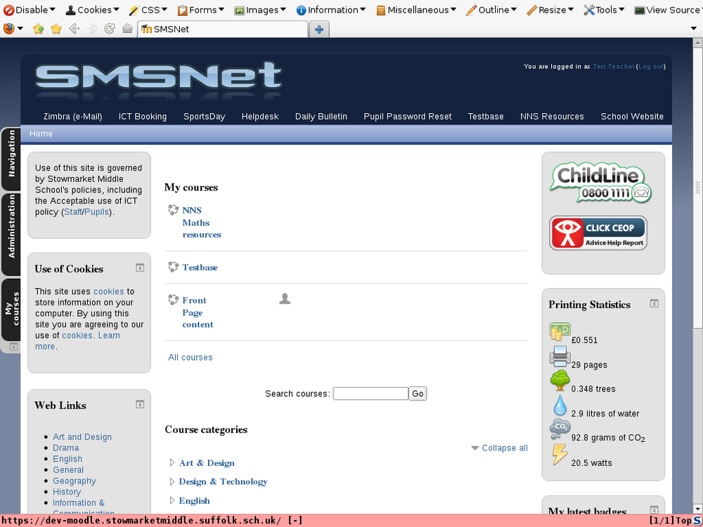

Does the PaperCut block in ZiLink work if the PaperCut server is not directly accessible, i.e. if Moodle is accessed from home?
If not, and anyone wants that ability, I've got a couple of blocks which use the PaperCut web service to grab and then display the relevant data. This also prevents the need for clients to trust the PaperCut server's certificate, as only the web server ever connects to it.

Nice work. What is the output like compared to the papercut widgets?
The output is plain HTML so it should follow your site's style, which IMO provides a better look than the widgets.
The main block shows the user's balance (if they are unrestricted) and the environmental statistics. The quota block simly displays the user's balance if they are restricted.
I've done it this way as it suited our needs, but if you'd rather just use the main block for everyone, whether of not their printing is restricted, just comment out or delete lines 65 and 75 in block_papercutws.php
Also, the blocks are hardcoded to use pounds sterling, which isn't ideal, but was good enough for us and should be fairly easy to adjust.
One last point, the webservice API doesn't give access to the environmental statistics so the block has to calculate them itself, so expect them to be different than the ones Papercut lists.
The main block:
The main block in context:
