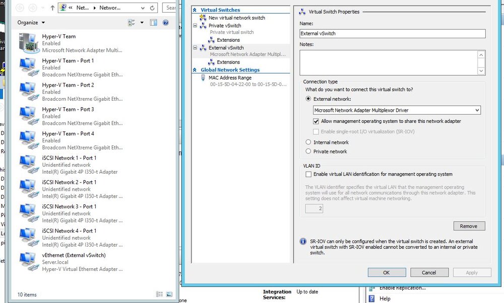

can you post a screenshot of your hyper-v virtual switch manager?
my initial suspicion is that the "allow management operating system to share this adapter" is ticked

The tick box is indeed ticked as per the screenshot - but does appear to be working as expected presently. Will monitor and decide tomorrow if it's worth opening up the EduTeaBags in celebration.

i never allow the physcial NIC to share the adaptor , its best practice to have a dedicated NIC ( or teamed) for the host and a dedicated ( or teamed ) for the virtual switch.
but i notice you have 2 virtual switches, whats the private virtual switch used for?
