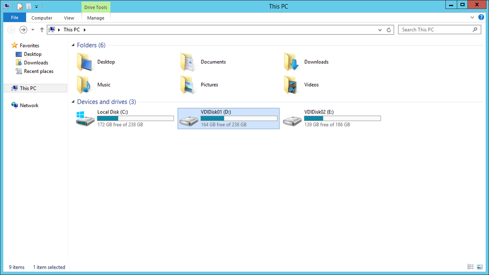

Each of the C6220 nodes are allocated 3 SSD disks
SSD A - Standard Dell SSD (Dell OEM LCS-256M6S) -for the OS alone (Sever 2012 R2 Datacenter with Hyper-V 2012 R2)
SSD B & C - Intel S7300 SSD
Each host therefore has 3 drives, we split the VDI's across the remaining two SSD's in each node.
On the D drive we have a copy of the Gold Image (vWorkspace calls it HyperCache) - basically one gold image held centrally (and you only update one gold image), but its copies it to each host for local speed, etc. and 8 VDIs in fact..

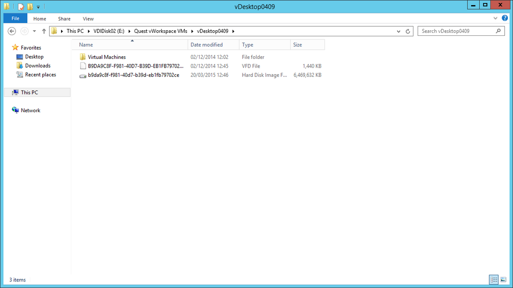

On the E drive we have 20 VDIs example of a VDI is
its a fraction of the main gold image, some are 4gb some are 8GB, it all depends on whether they are persistent desktops etc... but on average they are 6GB
Our Gold VDI Image is 32GB
The system is set to make sure that we have a minimum of 150 VDIs across the 4 boxes and auto-provision another 20 as soon as we hit 140 concurrent connections (which we only do at around exam time etc) - it can provision and fully setup 10 VDIs in less than 5 minutes.
