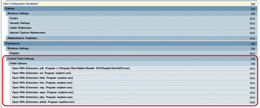

mcoyne Posted March 11, 2015 Posted March 11, 2015 Hello ninjafish, This isn't 100% what you're looking for, but we found that setting IE as the default for various extensions has helped a lot: 1
ninjafish Posted March 11, 2015 Author Posted March 11, 2015 Cheers Mcoyne i will give this method a try and let you know how it goes.
mcoyne Posted March 11, 2015 Posted March 11, 2015 You're welcome, fingers crossed it at least helps a bit! You think this would be easier wouldn't you. The other side of this is whether or not you want to disallow access to other browsers, which you could use Software Hash policy for. 1
ninjafish Posted March 12, 2015 Author Posted March 12, 2015 Hi Mcoyne, setting the open with rules looks to have done the job perfectly, many thanks
